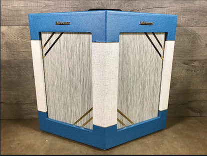

Put the two 15" speakers in a single cab, they're light enough. Maybe make it a V front like the old Watkins Dominator..
