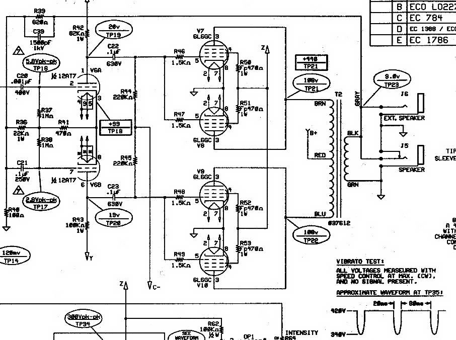

Can anybody answer this question:
When you buy two matched pairs of 6L6's for a Fender Twin, in what position do the matched pairs go?
Let's call the power amp valve positions 1, 2, 3, 4 looking at the back of the amp from left to right.
Do the pairs go in positions 1, 2 and 3, 4?
Do the pairs go in positions 1, 4 and 2, 3?
Do the pairs go in positions 1, 3 and 2, 4?
Over the years I've had people give all the above answers. I've never been able to get a definitive answer. Does it even matter. Can somebody please put me out of my misery?

Postby Basil Henriques » Wed Aug 11, 2010 7:38 pm
Valves 7 and 8 matched and 9 + 10 Likewise

Postby Mark » Thu Aug 12, 2010 9:15 pm
Paul,
It's very unusual for Baz not to get the correct answer, but on this occasion he is incorrect.
The correct answer is: It's best to buy a matched quad. By using a matched quad, the current as set by the biasing will be equal in all valves and no single pair of valves will be stressed.
If you have purchased two matched pairs, you can use them, it's not an ideal situation because one pair of valves will be stressed more than the other pair. But this is how to fit them: Using Baz's drawing for valve numbers - viewed from the rear of your Twin, valve 10 is the on the extreme left hand side. Heading to the right it goes 10, 9, 8, 7 and then onto the preamp valves.
Put one matched pair in positions 7 and 10. Put the other matched pair in 8 and 9. In this way the summation of bias currents in each half of the output will be the same and you will get a symmetrical output. If you fitted the valves as Baz suggested, your output would not be symmetrical. At higher volumes this will cause a few problems! Unless of course the valves are all matched!
That's another good reason for buying a matched quad, you can put any valve in any position.
I usually go one step further and measure the bias current of each valve and select the valves so the higher bias current valves are placed in the cooler positions. To do this requires special equipment. But it does raise an importance point; keeping your valves cool greatly extends their life. A nice little quiet fan will work wonders!
I hope that helps to put you out of your misery!

Postby Paul Brennan » Tue Aug 17, 2010 6:39 pm
Mark, thank you for this information. Like Basil I thought, from referring to the circuit diagram, that the pairs went side by side (1, 2 and 3, 4). However, I had a suspicion that it might be 1, 4 and 2, 3. So, I take it if you want to reduce the power of the amp by removing power valves you'd remove either the inner pair or the outer pair.
