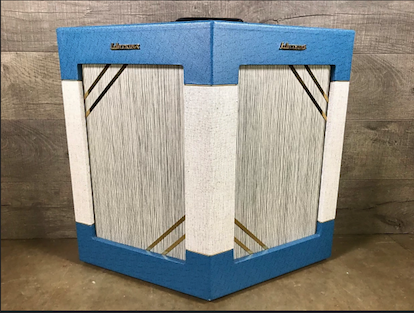

NOT if he does what I suggested Danny; a V front cab like the old dominator..That would give an adequate spread, On reflection I may go that road myself..

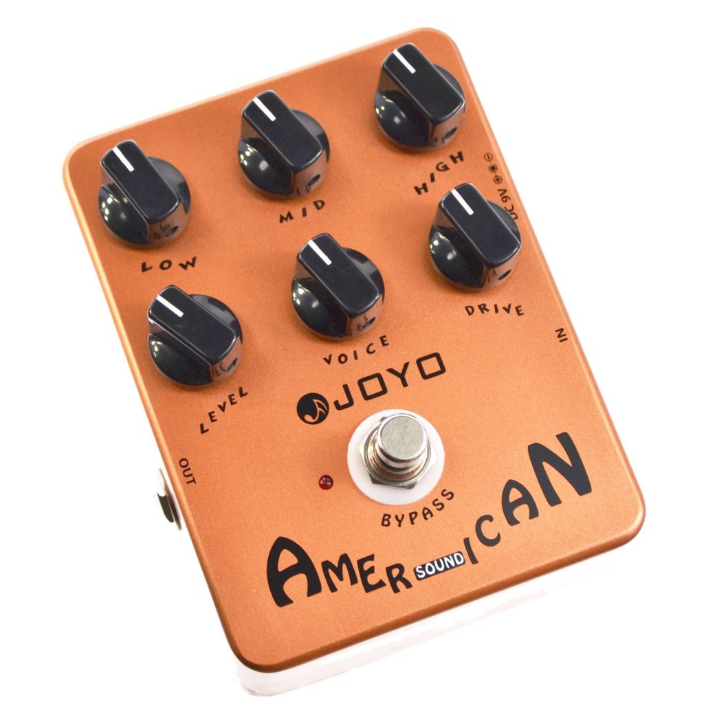

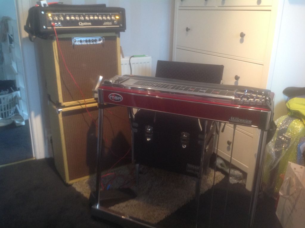

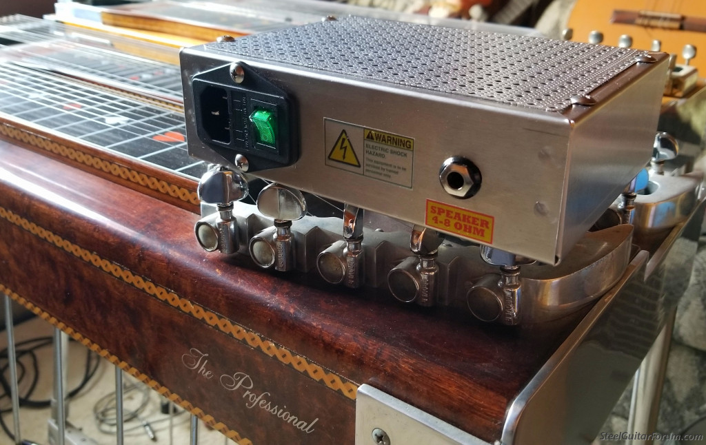

Davie, if it helps I am using two different rigs, one is a Joyo American Sound stomp box Pedal acting as preamp, into Digitech RP150 ( just use the left output Marked Mono use) into a Jay Ganz Straight Ahead 500watt class D amp, ( just slightly larger than a normal stomp box for those who have not seen one) into a tweed covered old Nashville 400 cab fitted with Telonics neo 15inch 4ohm. Had absolutely no problem with it, whole lot weighs in around 25 lbs. Second rig is a 12inch 4ohm Sica neo speaker in a small open back cab, (about 20lbs)which I can use for smaller gigs with the Joyo/Digitech/ Straight Ahead , or my stand by amp a GK MB200 which is built into the speaker cab for emergencies, which so far have not happened.
Middle pic is of both cabs when I was using Quilter Steelaire head. I prefer the sound of the 12inch speaker.

Davie, just another thought, the Telonics 15 you have is the same one fitted in the Telonics amps which I believe are 500watts, so can’t see there would be a problem.
