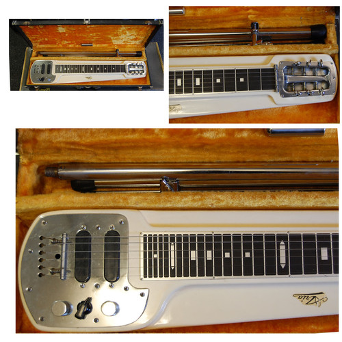

No exactly like your red picture and no cover, but with added switch between the knobs.
Actually, because one pickup is not working I may have misunderstood the function of that knob and it might actually be a blend control, but it is not working either as I stated. I just thought the lack of detents was a malfunction, but if it is a blend the good pickup should reduce in volume when turned, now I am confused.

I posted the picture of the white one to show what I thought the bridge was like (the "saddle" as you call it) - which I can now see is the same as yours. What about my idea of turning the bar upside down so the string slots are on the underside? (it should actually be completely smooth with no slots at all - maybe the previous owner filed some slots in it for some reason - can't imagine the strings wearing slots into the bar on their own).
The good pickup would not necessarily reduce in volume with the blend control - as I remember, one of them stays on all the time and the blend control fades the other one in. In any case, it should definitely be a pot, not a switch.
It would originally have been a little wheel under the chrome bridge cover (you can see the hole where the shaft would have come up next to the bridge between the 3rd and 4th strings). It would have looked like the little thumb wheel you can see on this Stringmaster. In any case, I'd hold off on getting a replacement until you get the pickups replaced in case it is working.
Another thought - maybe the previous owner messed up the wiring when he re-located the blend control. Have you tested the "broken" pickup in isolation to see if it works after all - maybe it just isn't wired in to the circuit?

The blend pot has been totally removed, and the wiring is a mess, I have removed the bridge and looked at it under a magnifying glass. Slots been cut in the wrong places then filled in with something to try and level them, , a mess, but luckily nice and smooth and shiny at 180 degrees, the nut is also like new underneath. Took off the scratch plate and is definitely a large and old 3 way whirch so worn the positions do not make contact. I will try and locate the pickup wires and see if I get a reading. Thanks for the input. Found a wiring diagram on this site
http://www.juststeelguitar.com/pickups.html
Now that the hole has been cut, I think I will convert it to a blend
