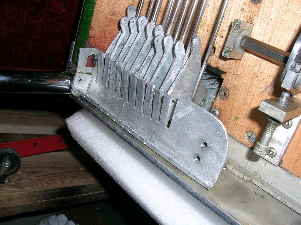

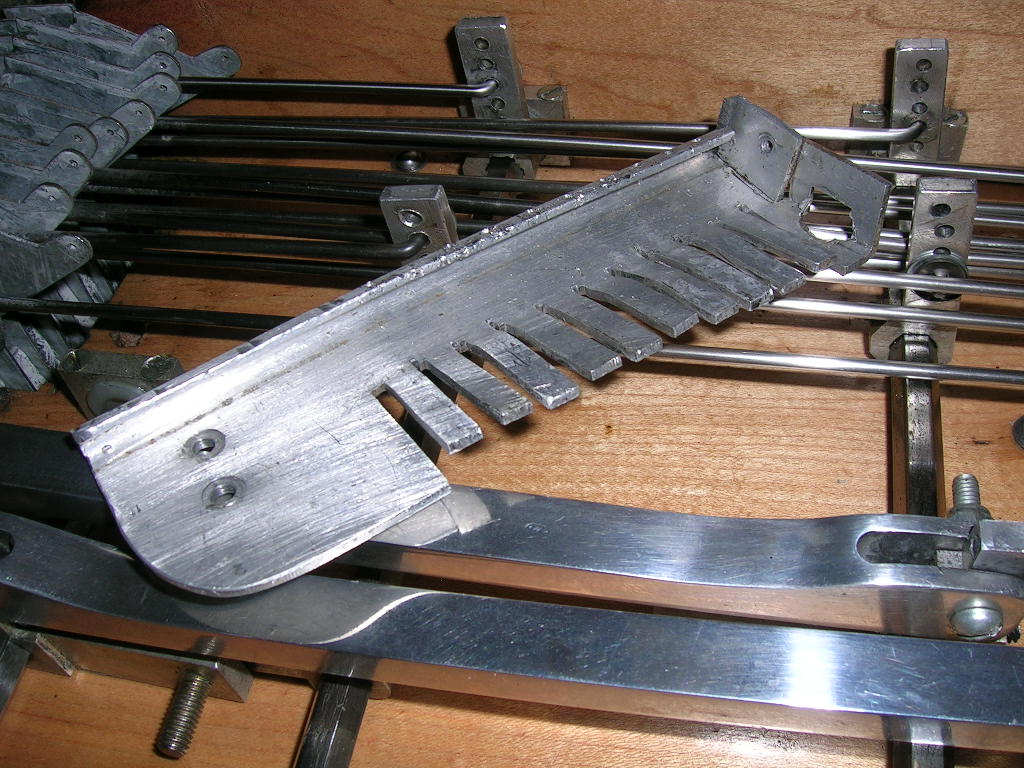

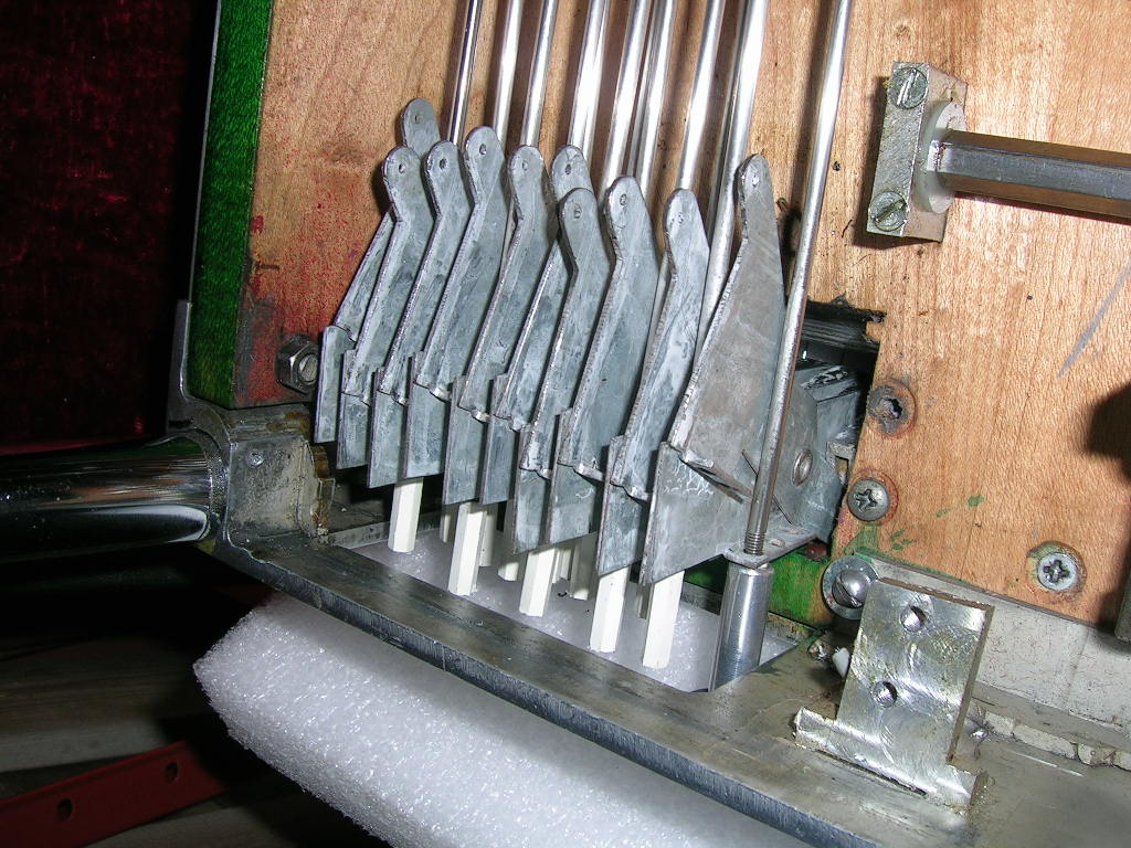

Postby tonewheelkev » Fri Nov 18, 2011 11:15 am
Thought I'd upload these!
Problem is with the essentially home-made spring retainer/end stop......the wobbly aluminium bit that looks like it was made by a one armed, short sighted third former!!! :lol:
(....S**t....hope it was no-one out there!!)
If I can get a good view of what should be there, I can have a stab at making something better....
....or might I find a spare part :!: :!: :!: :?: :?: :?:

Re: Pics of LDG type changer anyone!!!!
Postby Ken Byng » Sat Nov 19, 2011 5:24 pm
Kev - there were a number variants of the LDG. The original single raise, single lower rack & barrel, then the Pro 1 & 2 type double raise single lower and double + double, and finally the Pro 111 and Superpro types triple raise double lower variants. Some were pot metal, some were not.
Postby Ken Byng » Sat Nov 19, 2011 5:38 pm
Kev - you could get some 1/8" steel plate and cut it out yourself. Make sure there is enough clearance for the changer lower fingers not to bind. If you go to http://bb.steelguitarforum.com/viewtopic.php?t=215169 you will see that I upgraded my MCI changer springs by adding an anchor bracket and changing the springs. On my guitar there is just a flat plate (not slotted like yours) that hold the fingers in place against it.
Postby tonewheelkev » Sat Nov 19, 2011 5:40 pm
Hi Ken
...I'm informed that the guitar was built to a LDG spec...but hopefully, from the earlier attached pics, you can see what I have at the mo'....
I think that part of the original changer....that includes the single string retainer...is missing.
It has been replaced by an 11 slotted homemade affair....and this is quite temperamental, and fiddly to set up.
......not sure that it needs to be slotted in fact.
Postby Ken Byng » Sat Nov 19, 2011 6:20 pm
Kev
I've never seen any Sho~Bud finger retainer plate look like the one you have pictured. It is normally a straight edged plate.
Posts: 3368
Postby tonewheelkev » Sat Nov 19, 2011 7:05 pm
Ken Byng wrote:Kev
EXACTLY!!!!! :mrgreen:
