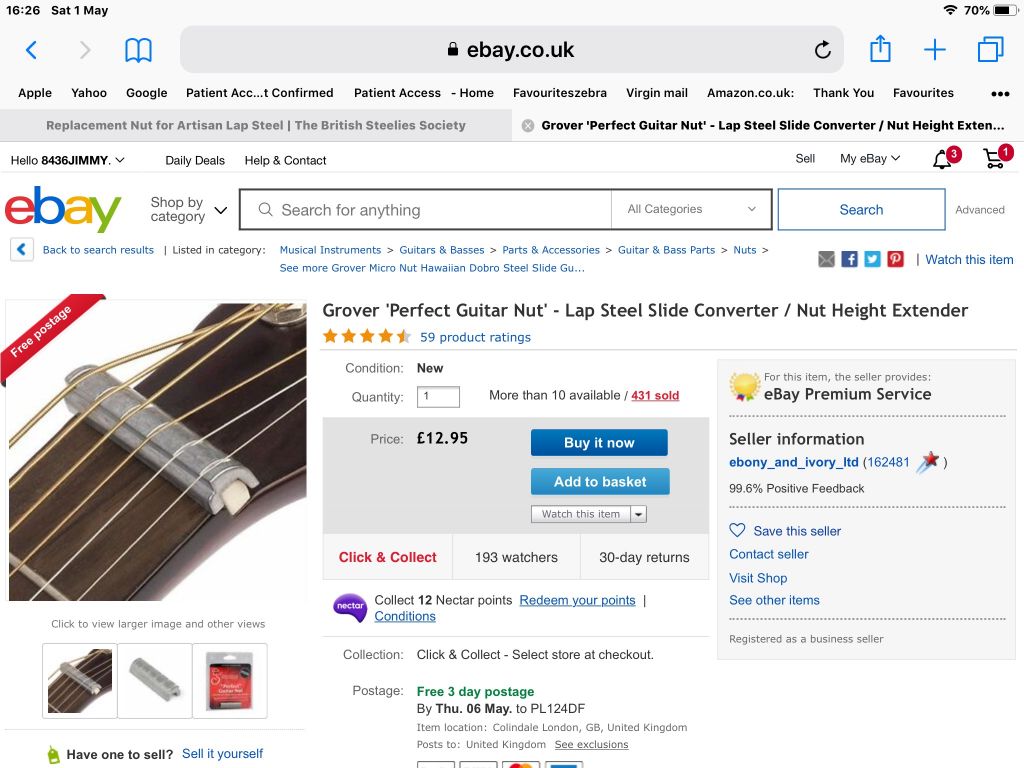

Postby Arcada » Sat May 01, 2021 4:06 pm
Jimmy Gibson wrote:This is for the member looking for a nut for his lap steel.
A link would be more helpful than a screenshot?

Postby Jimmy Gibson » Sat May 01, 2021 4:54 pm
Cheers Mark,sorry but I tried to send it as a link,but I couldn’t get it to work.Please delete if not allowed.
Cheers Jimmy.
Re: Replacement Nut for Artisan Lap Steel
Postby Arcada » Sat May 01, 2021 5:09 pm
Jimmy Gibson wrote:Cheers Mark,sorry but I tried to send it as a link,but I couldn’t get it to work.Please delete if not allowed.
Posting links is always allowed in posts, so not sure what the issue is... I found: -
https://www.ebay.co.uk/itm/Grover-Perfe ... 1854771100
Postby michael murray » Sat May 01, 2021 7:01 pm
I have one of the Grover 'Perfect' Nuts which I bought last year for a conversion project for a friend. It was slightly too wide.
It may not be as perfect a solution as TRD is suggesting but it may get you back in the saddle again.
It's approx. 48mm wide. String spacing around 8mm.
PM me your address and I'll get it into the post to you on Tuesday.
