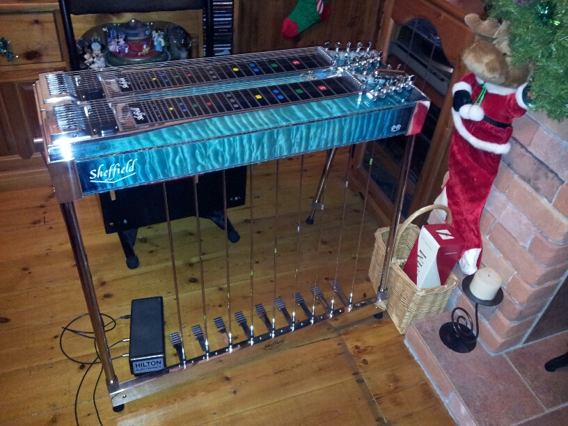

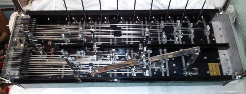

One point of interest in the discussion about pedal steel guitar tone is this. I have played virtually all of the different makes available over the years. One particular guitar that I have tried is head and shoulders above nearly everything else in the sustain department. That guitar is the home grown Sheffield, made by my good friend Dave Wheelhouse. Dave's bodies are always lacquer over good quality maple. What I believe gives him that extraordinary sustain is the substantive block of aluminium that the changer is mounted on. The Sheffield is at least the equal of the MSA mechanically, and in some areas Dave has perhaps over-engineered it with a half stop on the A pedal for example and bearings everywhere. Still a great idea. Dave has designed the Sheffield more with an engineering eye rather than a musician's eye. He has used the Emmons push pull as the tonal template to aim for when building his guitars.

Ken...Thanks for the pictures of the Sheffield....That's the first time I have ever seen one....I can clearly see the good engineering practise Dave has used in this guitar....I will have to get a close up view and hear it .......Yes you are right on the stainless steel cross shafts...more weight......I would suggest aluminium rails down the sides to pivot the shafts on ....Downside is the cross shafts have to be a different material...Stainless has a corrosion problem with aluminium.....My solution would be aluminium shafts and aluminium side rails. Press fit a very light hardened steel sleeve unto each end of the cross shafts and then mount the shaft on a needle roller bearing in the side rails ....That's the similar idea to the Mullen solution........I can see what you mean about the way Dave has his changer mounted...It looks like, it has a very good solid base in the excellent end plates....Notice they are one piece....Also the bar down the middle of the under body makes for more rigidity, and solid fixing points for the Cross shafts....Certainly looks like Mr Wheelhouse has done his home work....Ken do you have one of these guitars ?.....I would be very interested to see it.........Let me know

I don't have one Ivor. They are custom built for every new order that comes in. Dave has managed to source exotic wood and inlays for his guitars, and much of the metal work is outsourced to a specialist engineer. He always has a potter around my guitars when he comes over, and likes to have a listen when I play them. :D
Dave even bought a Bradshaw Webb amp after listening to mine and comparing it to his own behemoth Peavey Session 500 in an A/B test.
If you look carefully, you will see what pickups Dave has on this blue guitar of his. I like to think I played some part in persuading him to go for the 705's. :lol:

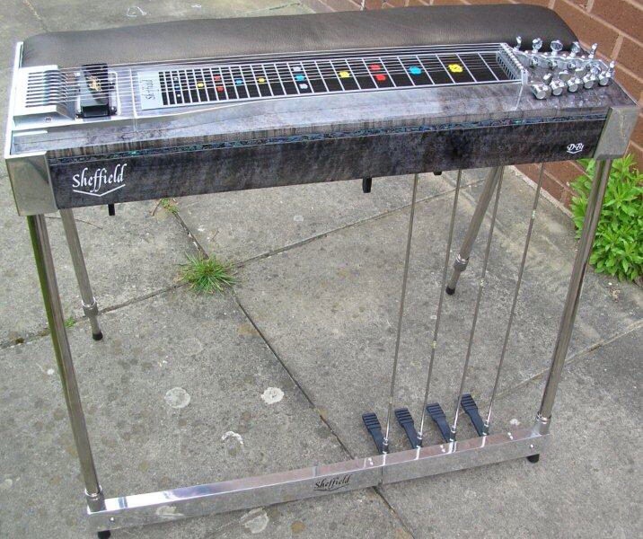

Ivor , this my favourite Sheffield.

Malcolm ...Thanks for the picture...Looks good....I will have to have a close up look sometime....Ted told me about Derek buying one ,sometime ago....Ted bought his Carter ....You can see from the underside picture's, how ridged the changer is fixed to the end plate...That along with the bar right down the middle would certainly make for a good strong body....Maybe that's why it sounds so well...Ken says the thing will sustain for longer than any other guitars he has had....... I would love to hear Derek playing his....I have always been a big fan of Derek Thurlby and Dave Kirk too.......
