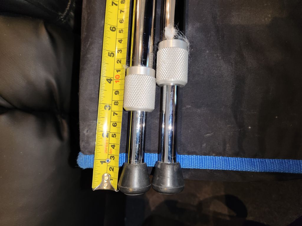

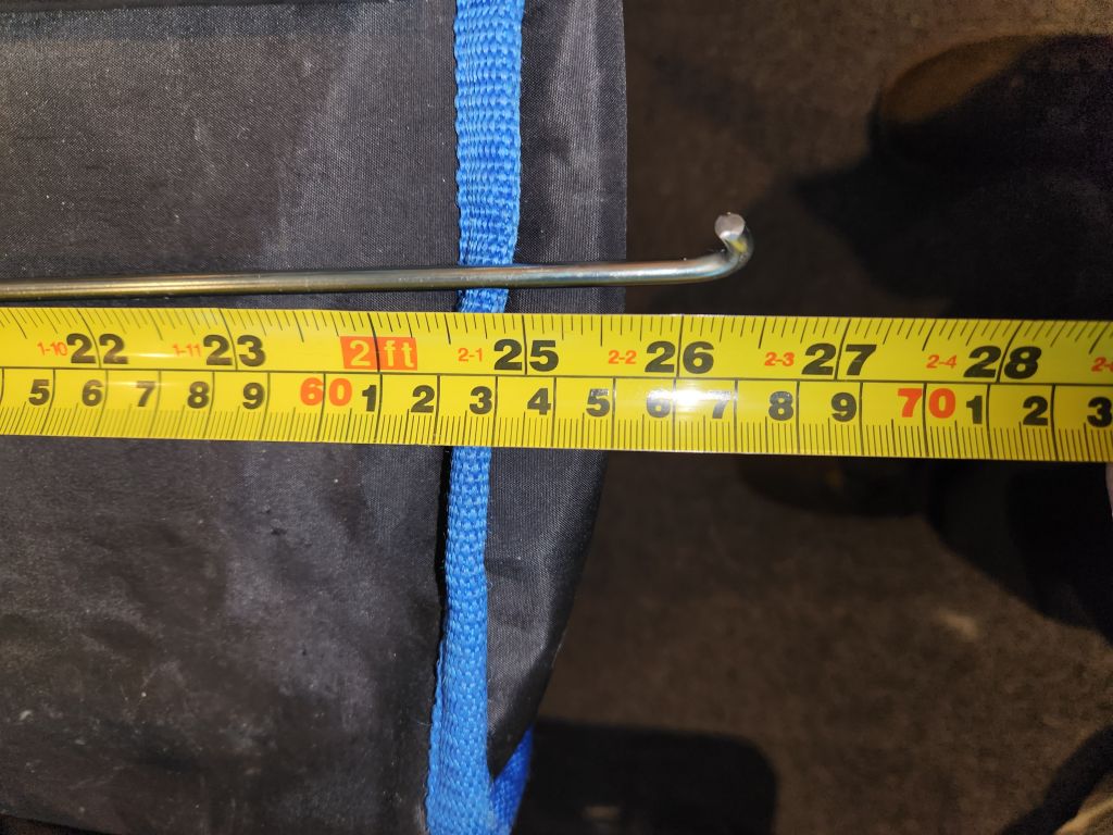

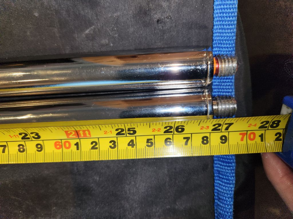

Postby Davie Holland » Mon Mar 25, 2024 9:41 pm
Now here is a conundrum....see photos of the legs from the Carter I got from you in Ireland. Are these supposed to be different lengths to the clutch? The ones with the longer shaft (to the clutch) are the ones I am using on the front, so could I lower the guitar by swapping the legs and shortening the rods? hmmm?? :idea: :idea:

Re: Lift Kit Wanted
Postby bob adams » Mon Mar 25, 2024 10:22 pm
Davie, If both internal tubes are going up to the stud to the same level (can't see the whole thing!) then your theory will work if you swap but you'll have to take an inch off the internal tubes for it all to sit lower. If your going tomorrow night bring them with you.
