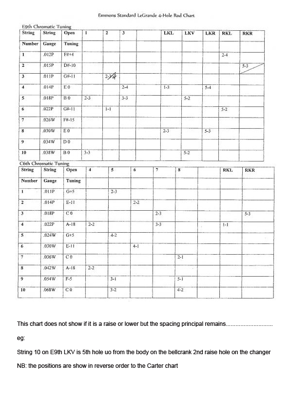

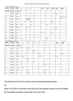

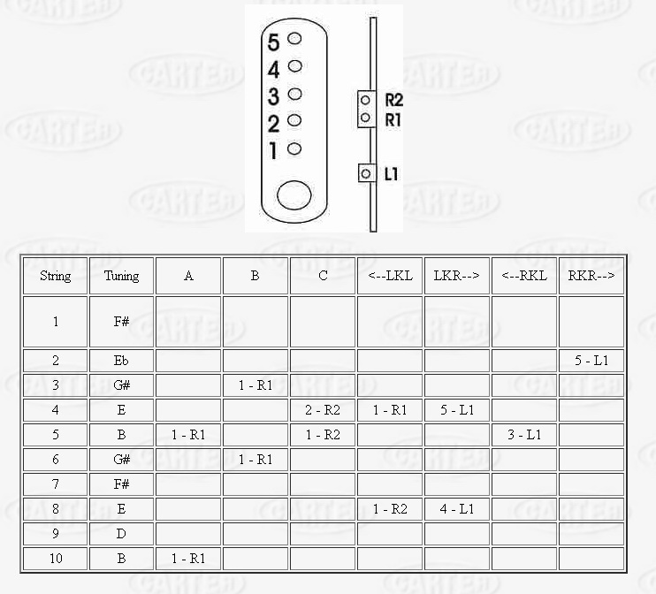

Postby bob adams » Wed Jan 27, 2021 11:50 am
Brad, attached some info on rodding you may find helpful,
Pic one explains the principal
Pic two a more comprehensive version for Standard setups.
