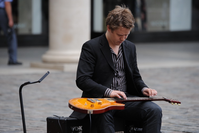

The photos show the LS2 Lap Steel. The wood selected for this LS2 is Sedrela (Spanish Cedar) for the neck and body, made up of a two piece ¼ sawn through neck plus body wings. The cap is Flame Maple, a rosewood fingerboard with MOP makers. The body and neck has cream bandings. (The LS2 can be made from Mahogany if preferred.)
Pick ups are Mississipps Queen (humbucker size P90) by Bare Knuckle
Sperzel locking machineheads, a TonePro Tune-o-matic bridge, with a Goto aluminium tailpiece. The pots used are CTS premium audio taper with a orange drop capacitor. The 3 way toggle switch and ¼” jack socket are by Switchcraft. The finish is clear Polyester.

Beautiful looking guitars, made with obvious attention to detail and expert luthiery, but, two questions, why 2 pick-ups (when al the major manufactures, Gibson. Rickenbacher, Epiphone, Supro, National, Fender et al. for the past 80 years have used just one, and that close to the bridge) and why an adjustable bridge ? :?:

The Lap Steels I make are not designed to sound the same as the Lap Steels you named. There is no right or wrong place for a pickup to be or if a guitar should have one or two pickups. This will depend on what sound you need, adding a neck pickup gives the guitar new darker sound that most Lap steels do not have, also two pickups give you increased tone options. Having said that my Lap Steels are not designed to give a Hawaiian type sound. (but they can!) These guitars are more of a cross over between a standard electric guitar being play bottle neck and a Hawaiian steel guitar (a hybrid if you like). If you’re a bottle neck player playing a Gibson Les Paul but want to play a Lap Steel and keep all the sounds of your Gibson then a Hawaiian steels is not for you. This is how this type of Lap Steel comes in to its own. The design is a Les Paul put into a Weissenborn shape. All the parts use to build these Lap Steels are top of range Les Paul parts including the tone woods giving all the classic sounds of a vintage Les Paul but in the shape of an Weissenborn. So that’s the reason for using two pickups a tune-o-Matic bridge etc. I should all say most of these guitars are played in rock or blues bands or a mix of both. I’m not the only custom builder to use this design, go on You Tube type in Ben Harper, Bill Asher or Gary Myrick this will give you what sound this type of guitar design for. (Unfortunately they are not playing Lap Steels made by me.) I hand build all the guitars from start to finish. The only thing I do not do is the paintwork.
Prices start at £1500 the model shown is a LS2 P90 custom. Price £1650. :guitar:

I would have thought that a lap steel should sound like the normally accepted "Lap Steel" otherwise why call it that ? The norm for a lap steel, is not an over-driven sound but more so a clean sound. Manufacturers go to great lengths to make amplifiers with enough headroom to reproduce steel guitars faithfully. So this guitar you make really is a specialists instrument that would belong in the world of bottleneck, blues, slide or rock.. Is it ?
In a similar way, I can't imagine an acoustic guitar being described as anything OTHER than an acoustic guitar, BUT a 12 string would have the qualifier attached to its nominative and likewise Nylon, or Tenor et al. To follow accepted nomenclature conventions your guitar "could" be called an Electric, slide/blues lap guitar, as for your choice of pickup placements, it show complete disregard for the players ability to obtain those tones you describe, by picking technique.
That still doesn't address the reason for the compensated bridge, do you mean it's NOT there for practical purposes, just aesthetically ?
I am NOT decrying you obvious passion and expertise in construction, it's just critique of your convention of naming, and also the complete lack of necessity for a compensated bridge on an instrument where the strings of varied thickness are NOT pushed onto a fretboard and require individual intonational adjustment.

that's a (real purty) lap steel to me !
don't give a hoot 'bout an adjustable bridge either
as long as it sings

AND, I think that for a £1,500 guitar to have a mass produced aftermarket bridge just because it's readily available, is not good business acumen. A guitar costing that much SHOULD have a purpose built customised bridge.
AND for the pickups on this particular guitar to be in their "Optimum Position" the bridge one would need to be almost a 1/4' nearer the bridge and the 'neck' one spaced the correct distance from it, taking into consideration the scale length..IMHO..It's the polepiece positions that are wrong, a Twin coil "Humbucker' would have the polepieces NOT in the centre but of-set in ONE of the two coils..

As I said before the LS2 P90 is a Les Paul built as a Lap Steel so as a Les Paul has a compensating bridge so dose my Lap steel, so yes you can say it is aesthetically used for looks but the practical reason I use it its sounds great. It is also one of parts that gives the guitar its sound. If it did not have this type of bridge it would not be a Les Paul Lap steel. The TonePro birdge is the best Tune-O-Matic bridge you can buy. I’ll say NO more about the bridge!
Mississipps Queen pickups sound great. Hand wound and made in the UK. Have a look at Bare Knuckle pickups, so many great guitar players are fitting Bare Knuckles.
Picking technique. You pick any ware to get the tone you want, see the Ben Harper link below he picks all over the place and he good I mean rely rely good if not the best modern Rock Lap Steel picker around.
