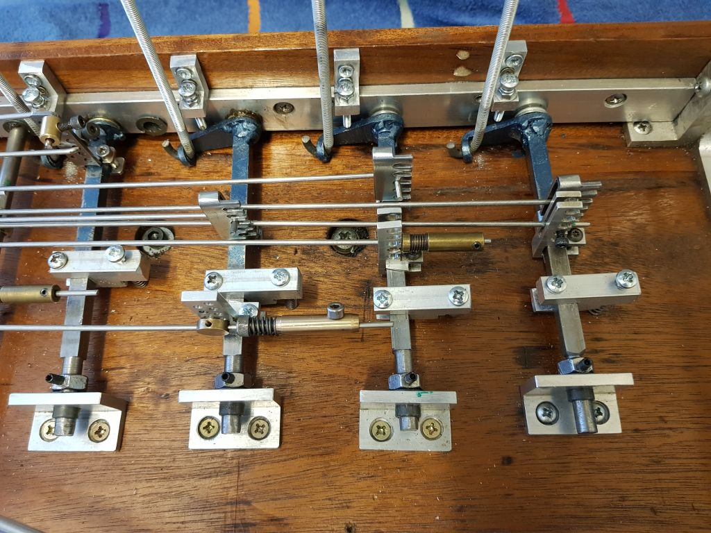

I sent a couple of pics to someone showing the underside of this guitar and they said it was unplayable! now I admit its a bit untidy and has a collection of USA odds and sods underneath but unplayable?! I think not...... Therefore I will sell this Lightweight D/B S10 for the massive price of 950 quid plus shipping and include in that price a Peterson HD tuner AND a seven day return it for a full refund if not entirely satisfied, I think that is being fair and reasonable. The guitar comes in a fairly large flight case, the tuner is used but in perfect working order.

This post has managed to get my finger out after 3 months retirement from guitar playing and posting, as I can't get out (at least 10 miles a day on a bike doesn't count ) I've got all the catchup jobs to do around the happy home and guitar playing is a bigger danger to my health than any virus, :o hopefully soon I can clear out my shed and start rebuilding last year's impulsive purchase a Springfield S10 . :oops:
I have already started work on it but someone else's clever ideas can never go amiss! :roll:

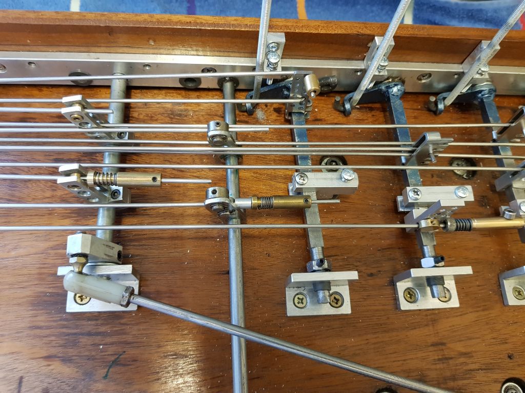

My take on the mechanics was first lose all that weight as I understand it Mr Kerr took advice from Mr Isambard Kingdom Brunel and built it to last the cross irons I think 10 mm but weighed in like 12 and it took two men and a boy to lift it. so I moved it down to 8m sq. for cross shafts and 8mm round for lever bars cos that is what I had in "Leftovers". Where you have two pulls on the same shaft I cater first for the thinner string cos it moves the most so i set the pedal travel stop to set that movement, as my travel stops are not substantial due to thin skirt this guitar and I have square shafts I find I can devise a further stop for the thinner strings on the cross shaft itself, this not only makes a more positive stop but if i fit a small spring around the thread of the protruding shaft stop it acts as a return spring for the pedal and a better feel on the pedals, The thicker string movement is just controlled by the old brass Shobud adjusters.
So, what I have ended up with is an extremely light double bodied "unplayable" guitar.
Standard GeorgeL E66 pick up

Your modifications are a vast improvement over the original cross shafts and stops ( or lack of them! ) the bushes on the shaft ends are a big improvement on the original " hole in the wall " set up.
The difference is apparent in the photo I've posted below showing the travel stops and rod adjusters on the 3/8" steel cross shafts, I have already made up travel stops similar to yours for the levers, for the pedal stops I have done the same and made up return springs for all the shafts.
I was thinking of making rod adjusters similar to Blanton ones but have put things on hold while I re invent the wheel!
Thanks for your input, that's a sturdy good,mechanicaly smooth, guitar for someone.
Cheers Robert
