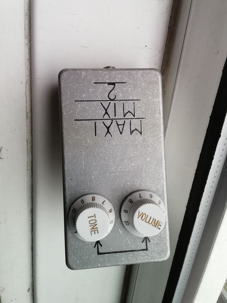

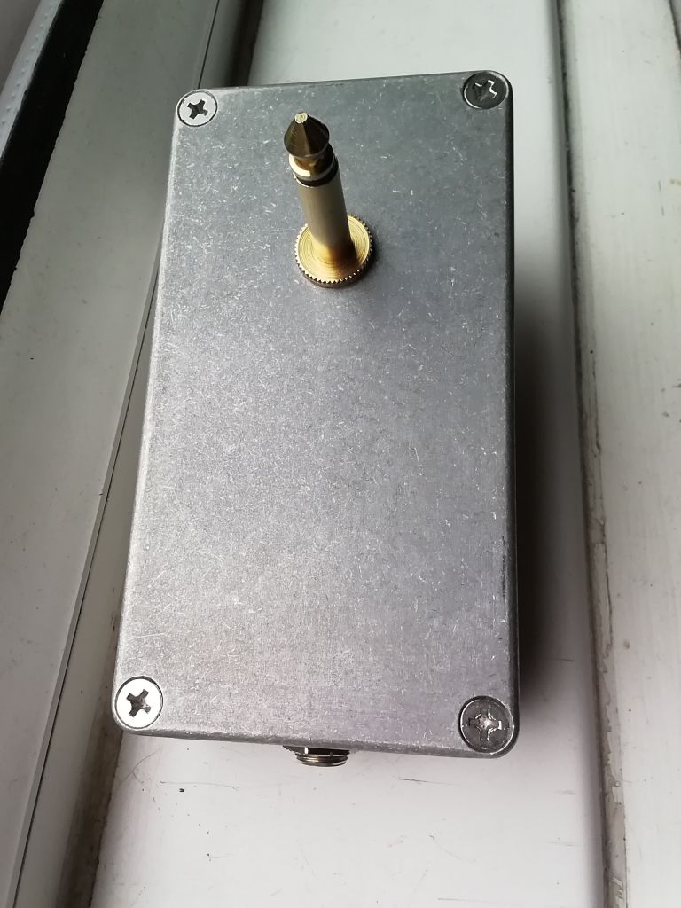

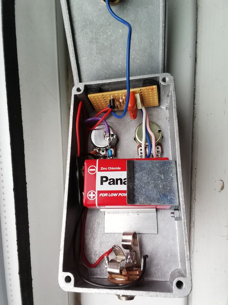

Dave, this is my version, very similar to yours with similar gain but with a Fender Grease Bucket tone circuit added, just a 500k lin pot and a 10 nan cap and a 22 nan cap. It's really handy having the tone at your finger tips. Just thought you might be interested. Cheers.

Many thanks for your reply and inclusion of your photos.It looks a great little unit and well made too.
