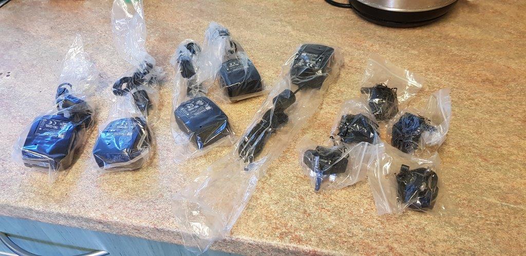

Having screwed up at least two of them as the power lead finds its way under the leg of the pack-a-seat I now carry at least one or two spares.
If anyone is interested I can send you one for 28 quid inc. postage

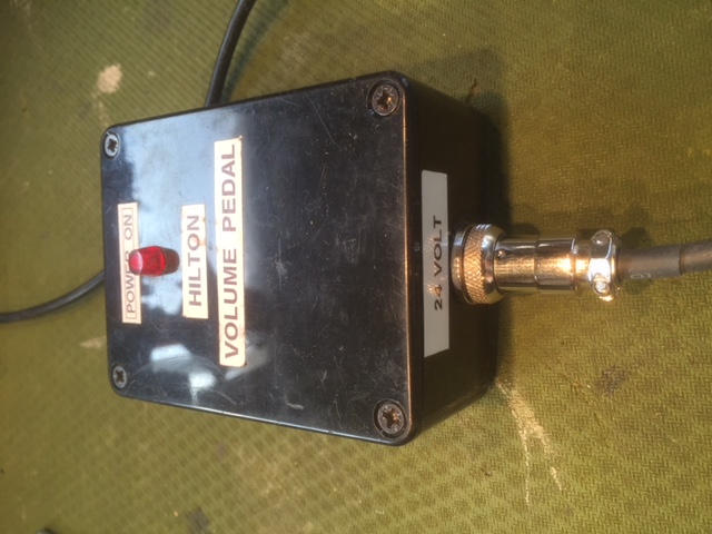

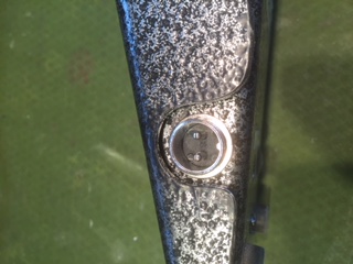

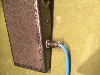

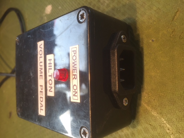

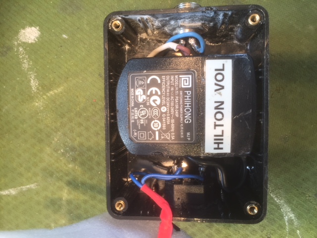

I also got fed up with either chopping through the thin cable, or the cable failing where it leaves the adapter.
So I bought a little box from Maplins, fitted the Hilton adapter in it, cut in a normal euro mains socket (always have a spare one of those in someones kit at a gig) then cut in a military type socket both into the box and the pedal, therefore leaving me able to use a good thick reinforced power lead.
Just for good measure I added a neon bulb just so I could look down and check it was on.
