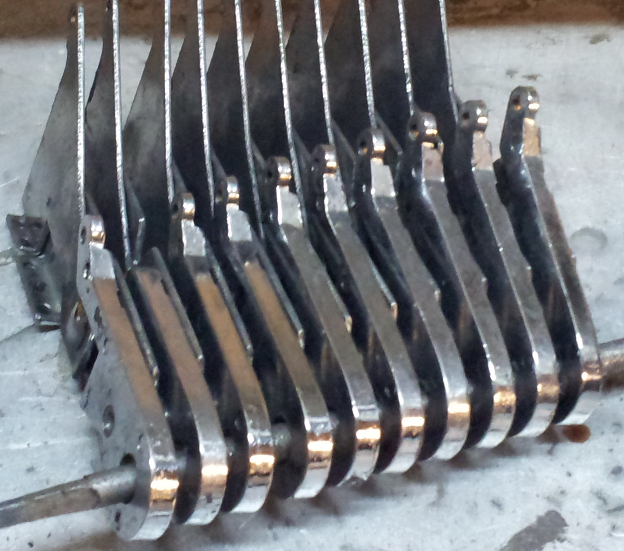

Easily identified Jonathan, check out the dimples, pic two shows the other side and the classic problem, in saying that it would never put me off buying one they are great guitars and worn parts are easily rectified.
