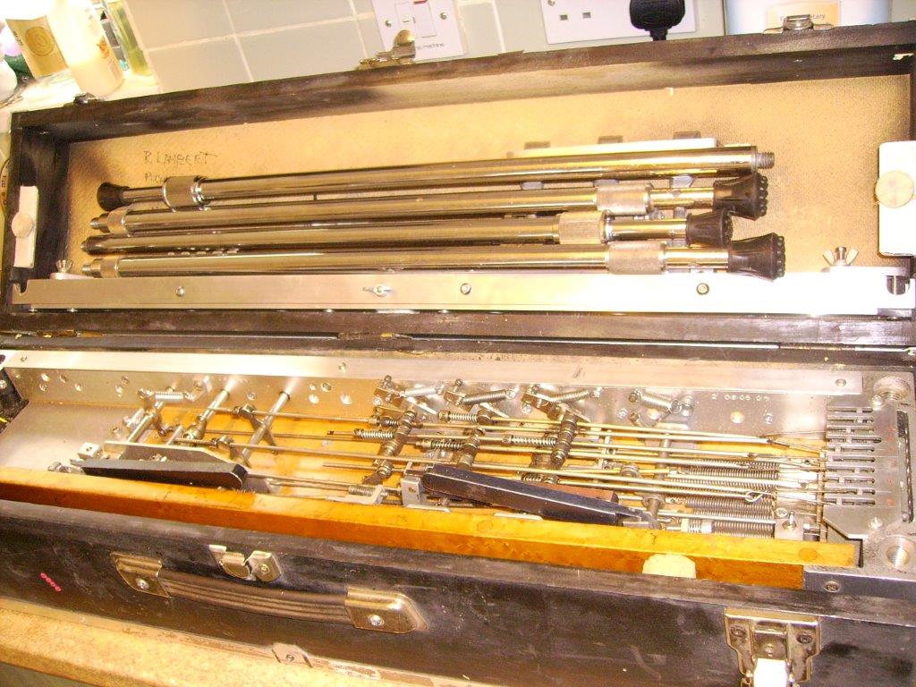

Postby JohnDavisStringsHere » Mon May 15, 2017 4:58 pm

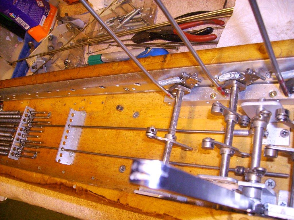

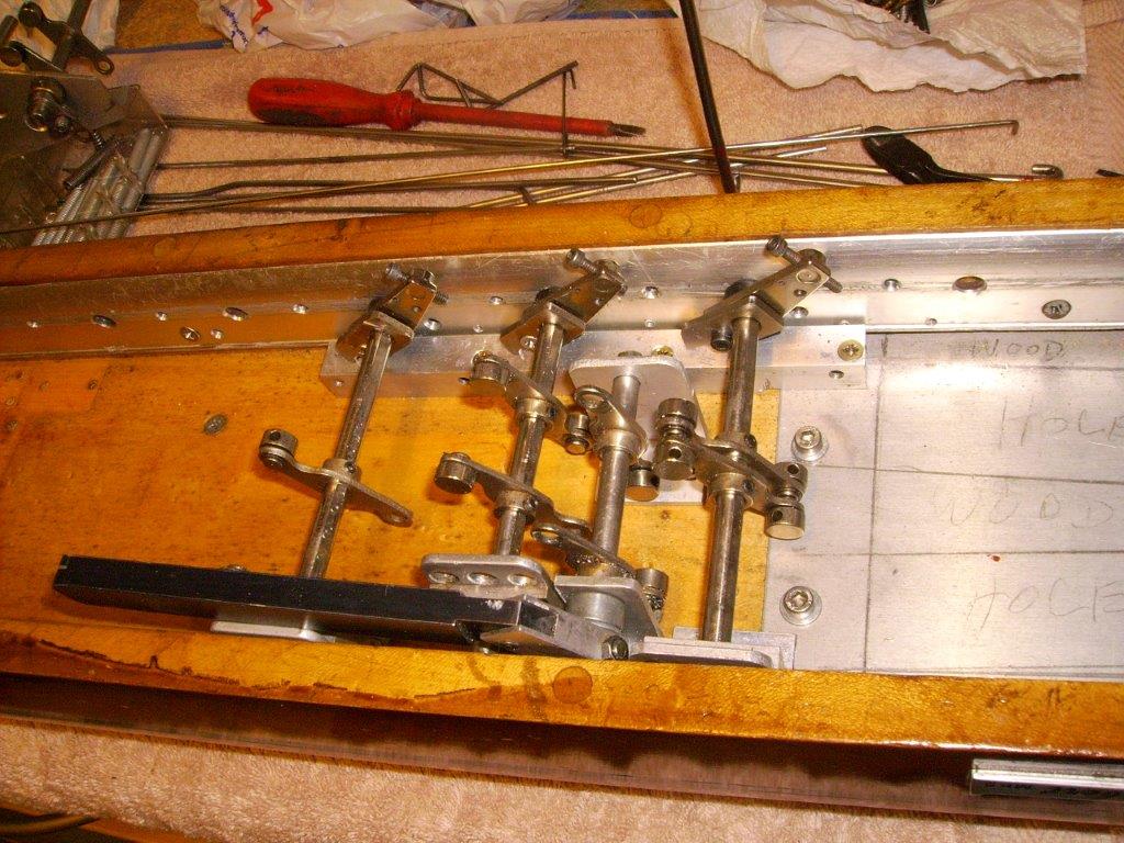

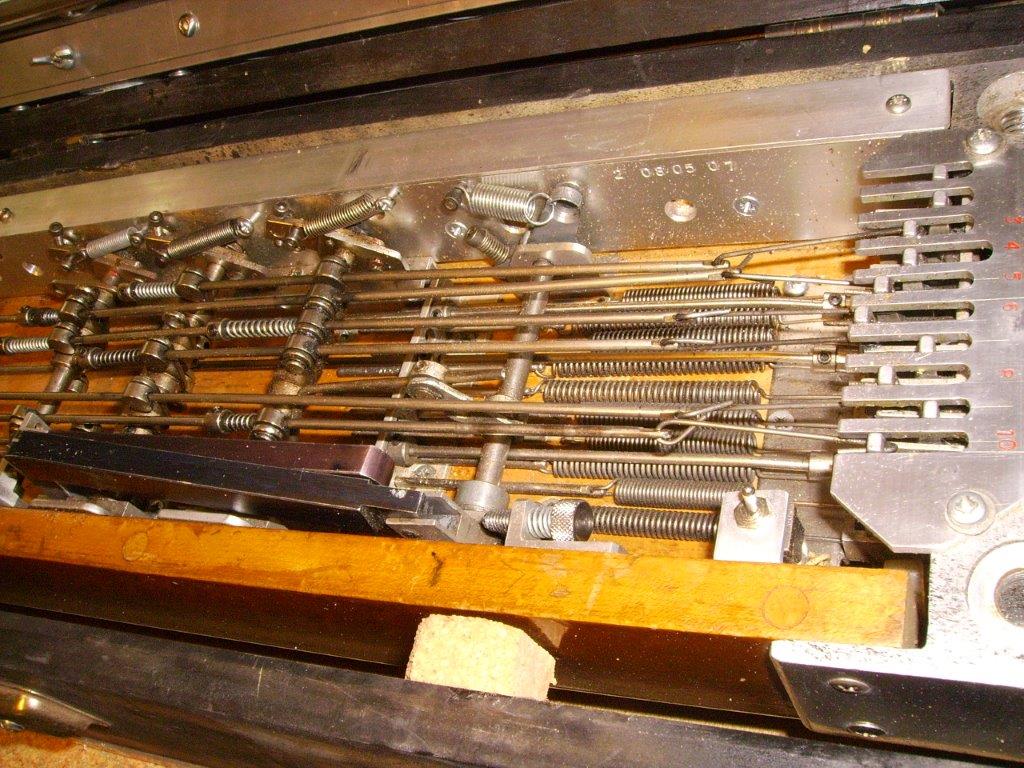

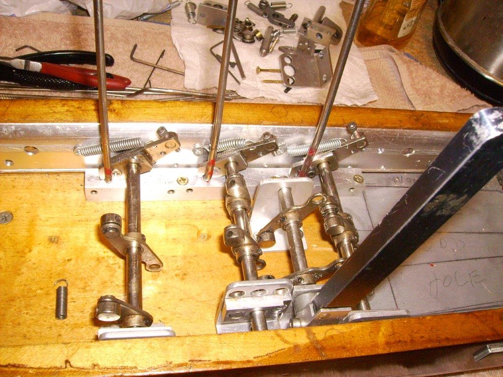

OK the "Shemmons" has landed and not to waste a lot of time I thought I would tear into it, here are some first pics.........

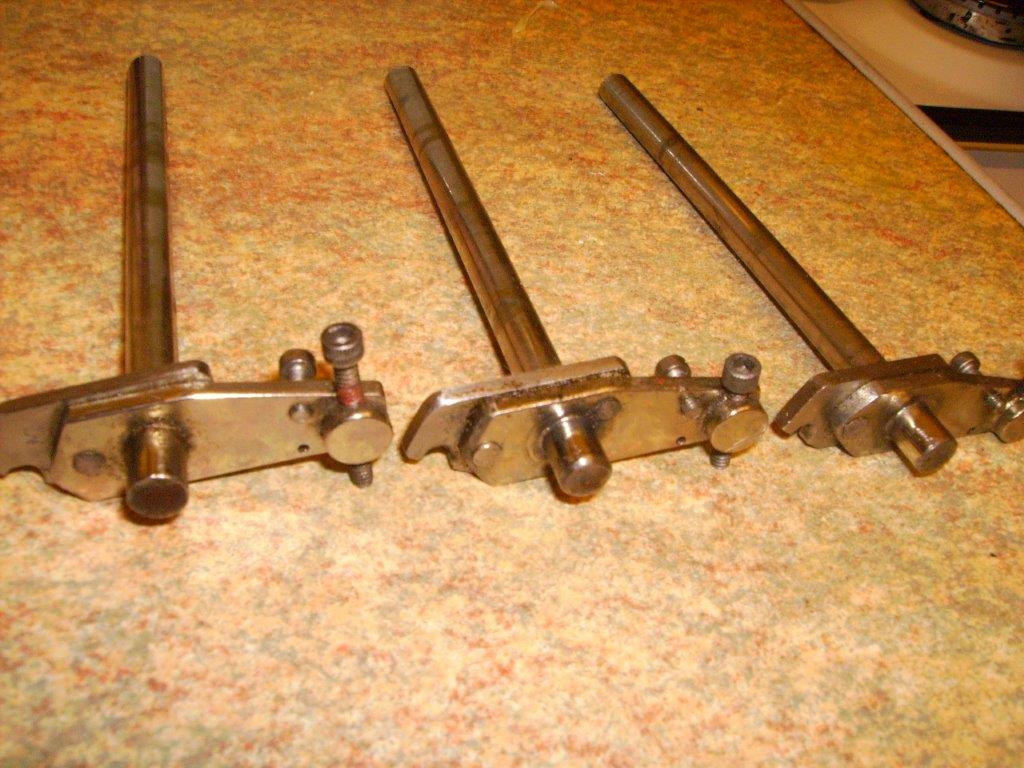

I need 3 pedal raising cross shafts, any chance you might have some? This guitar is an Emmons S10 in a Shobud body and to make things worse Left Handed! so the pedal shafts have been butchered, Can you help?

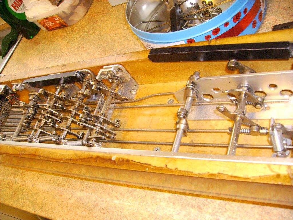

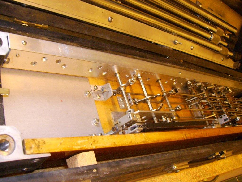

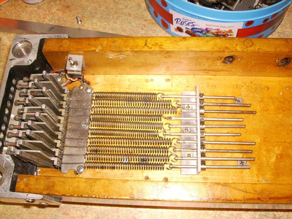

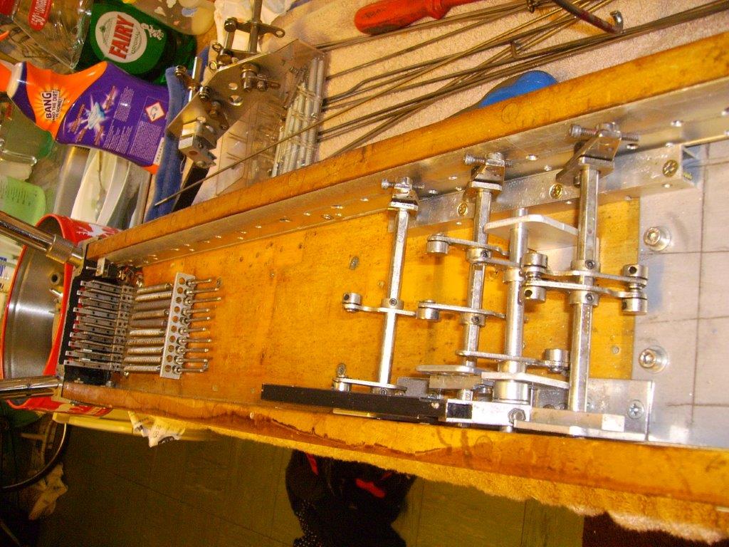

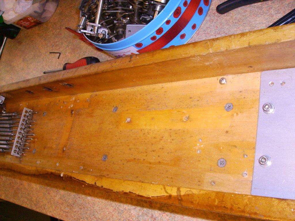

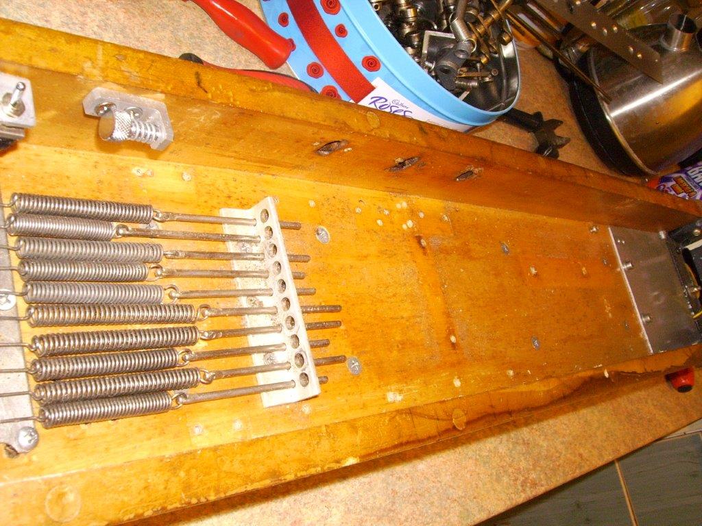

Postby JohnDavisStringsHere » Mon May 15, 2017 4:59 pm
more pics

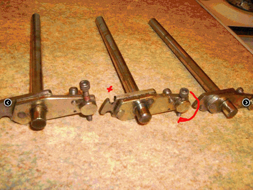

Postby bob adams » Mon May 15, 2017 8:51 pm
Can't you file out a groove for the pedal rod on the other side of that plate John and upturn the adjusting screw! ... to give you what you are after ???
Apologies for the crude edit!
Posts: 1736
Re: Coming soon to this Green and pleasant land.............
Postby JohnDavisStringsHere » Tue May 16, 2017 7:03 am
Bob with your brain and my lack of engineering skills we could almost make half a team :D , it was even easier than that as i could turn the rod grabbers over and I have but, it would be nice to have some unmolested originals if I could find them.......
