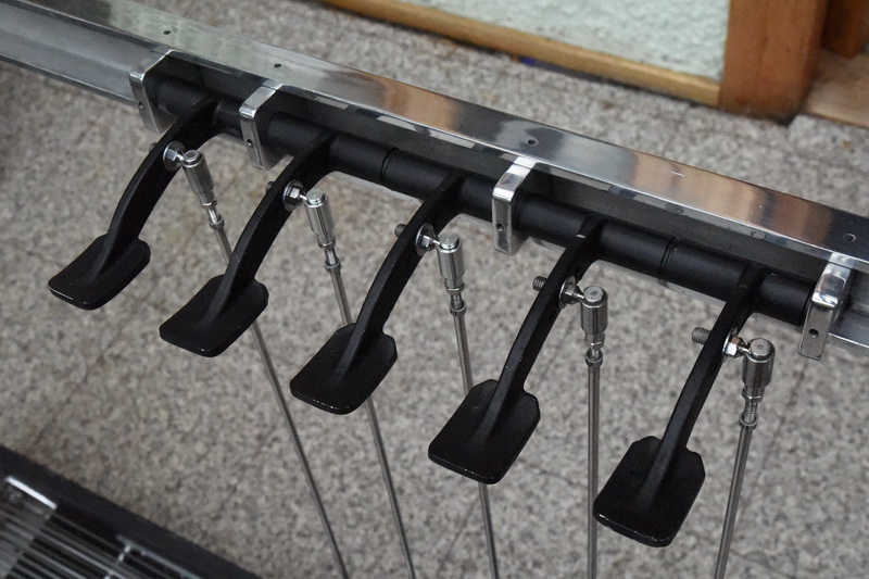

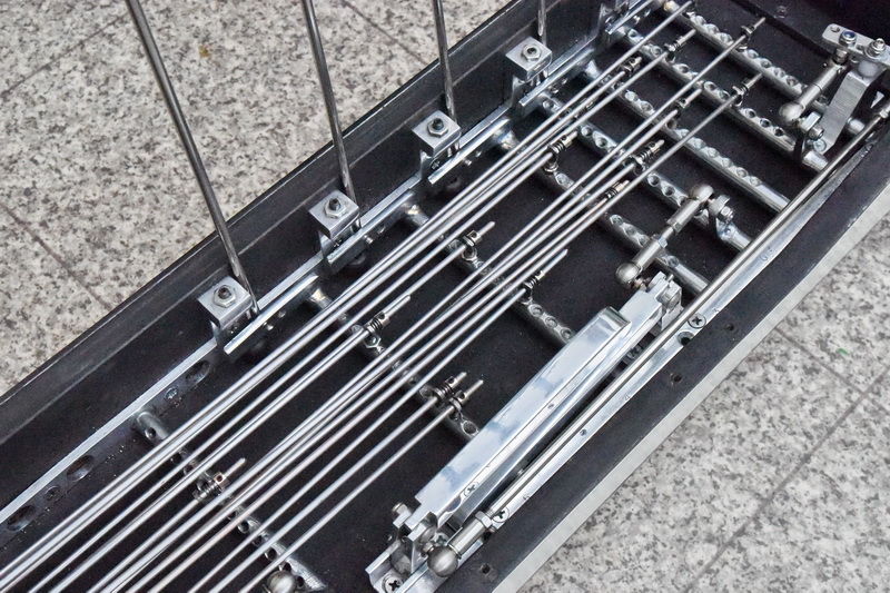

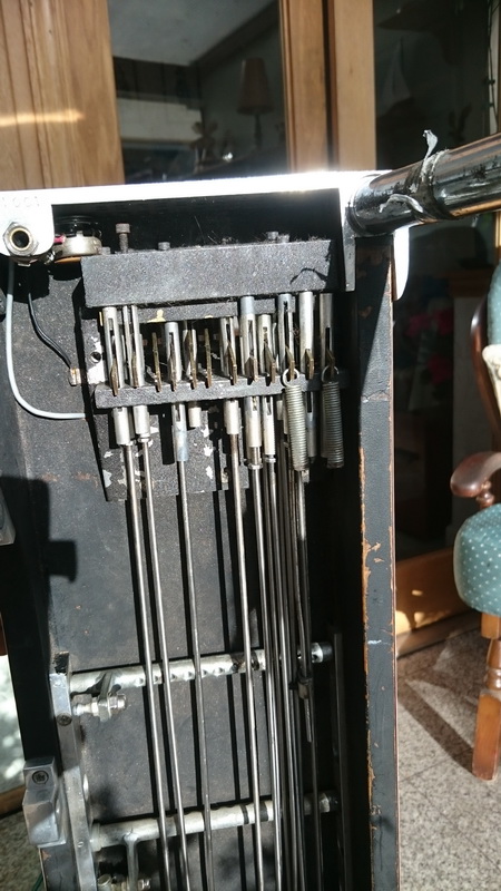

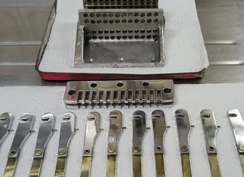

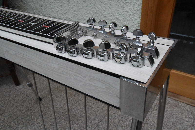

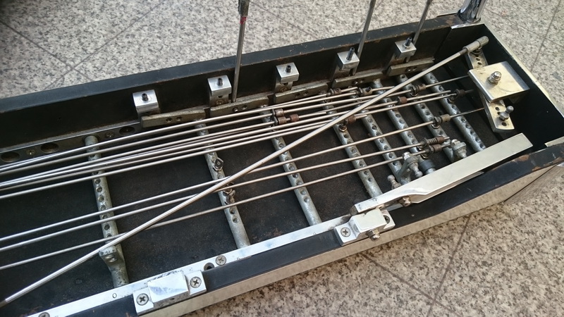

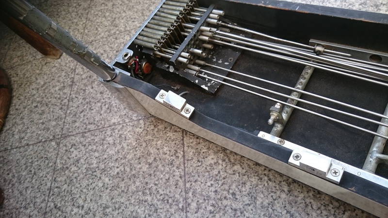

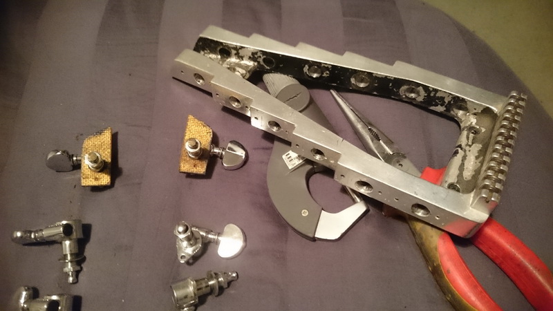

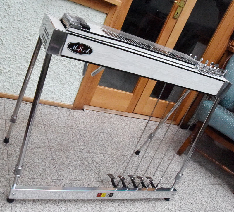

MSA 12
On arrival: no feet, loose pedal rack, two pedals only operational ('ish), loose grovers, pickup not fixed, eight adjusting screws remaining from twenty one changes, broken and missing black banding.
On exit: 5 x 4 setup, 4 new levers (2 reverse) replaced missing pedal rods and couplings, replaced grover spacers, pickup fixed with adjustable height, changer re-jigged and screws replaced, pedals TLC'd, black body banding replaced. polished.

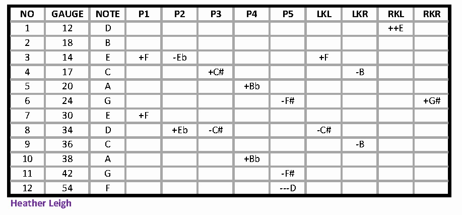

This guitar does not have a standard tuning, it is close to C6th but unique to its owner and was used much as a lap steel so pedal and lever functions were a work around. You will see from the copedent it is different but now produces some nice voicings.
BA

Postby bob adams » Mon Apr 06, 2015 11:09 am
Setup with a couple of specific requests

Postby Willie Gamble » Wed Apr 08, 2015 10:26 pm
What a difference Bob,its amazing what a bit of TLC and a lot of know how can do.
Thanks for uploading the pics
