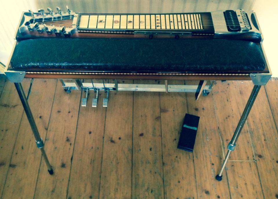

Managed to find myself an older ZB Custom (image attached) about 3 months ago. Emmons setup. Just been messing about/using YouTube guides at home with it up till now - starting to really get my head round it (I teach guitar which has helped a lot). Got a few questions though:
1) It'll be a while before I can afford an amp voiced for a steel. So, any general guides on using guitar amp settings to achieve a decent tone would be much appreciated. I also have a Line6 amp modeller (I know, I know..) - but I figured this''ll do the trick for now if I'm just playing at home and getting my technique up. So - which models might give me the best sound?
2) Where's the best place to look for free online guides? I also don't mind paying a little if they come recommended by everyone here.
3) I'm having some tuning issues with the levers. Kind of expected this given the age/price of the model, but I'm willing to work around it. The far left lever and the far right lever tend to detune their corresponding strings quite drastically (although the more I use them during one sitting, the less this seems to happen. Is this normal?). Any tips on sorting this/people in Edinburgh who might be able to help me? I was in touch with Bob Adams of pedalsteel.co.uk - who did a full service before I bought it. However, he's based about an hour away in Fife and I don't have a car...
Thanks in advance for your help, and looking forward to developing as a steelie!

Postby Dode » Thu Oct 02, 2014 6:32 pm
Hi Tony, thanks for the response! Listening to Bobbe Seymour as I type - beautiful stuff. Will also try out the Twin sound when I get a chance to practice later on.
I should have been clearer when talking about the knee-levers; what I meant was that 'LKL - half tone higher, 4 and 8' + 'RKR - half tone lower, 2 and 9' perform as they should when engaged, but when I revert the levers back to their resting positions the strings are often wildly detuned - i.e. what should be Es are now closer to Fs for instance. As I said, the more I engage these particular knee-levers the more the problem goes away. So it's something I can work around, but a little frustrating knowing that the first few times I use them at each sitting will result in me having to stop and re-tune. LKR and RKL are absolutely fine. Hope this is all clearer?

Postby bob adams » Thu Oct 02, 2014 7:30 pm
Yo Dode, !?
Good to see you’ve found your way to the forum. We did speak briefly on the phone and yes my advice was to buy at the price you were paying, it was a very good deal. In reality what happened was the seller contacted me re. some things that were broken or not right
as he wanted it in reasonable shape to sell, I did fix a number of things as time permitted and in part as a favour but I didn’t present it as a ‘full service’ These guitars just need a little TLC to tweak out minor problems. If the LKL return is affecting 8 & 4 (its own change) then it would most likely be a spring issue but if it is affecting other strings it sounds like those LH/RH turnbuckles are fouling a tad. To be honest ZBs run much smoother if the rods come straight from the changer and adjust with a nut at the yoke/ crossbar doing away with those couplings altogether! I am busy over the next couple of weeks in the run up to Ireland but happy to have a look at it sometime after the 18th-19th weekend. Where are you in Edinburgh? For the record and tech work I do on steels is done in Glasgow, that’s where the tools are! Good luck with it in the meantime.

Postby Zebedee » Fri Oct 03, 2014 5:02 am
If the 4th string does not come back true after being raised by the knee lever, it could quite possibly be the 'C' pedal and its linkages to the 4th string that is causing the problem.
Take a look at the underside of your steel, and see if the 'C' pedal linkage is tight or binding on other rods.
Check that the 'C' pedal is free to move on its axle on the pedal bar.
Put your foot under the 'C' pedal (to stop it dropping) and activate the knee lever (that raises the 4th string), then release the lever, and see if the string returns true.
ZeBedee aka the spring man

Postby Dode » Fri Oct 03, 2014 12:38 pm
Hi Bob (Dode is Scottish for George..)! Hmm that's interesting - the seller gave me the impression that it was a full service. Anyway, I really can't complain too much.
The LKL is only affecting its own change - i.e. 4 & 8. Same with the RKR (though the problem for this knee-lever is nowhere near as bad). I think Zebedee might be on to something (thanks for the tips by the way!): the LKL issue seems to be linked to the C pedal. As mentioned before, if I use the LKL a few times in a row the problem starts to fade until it goes away altogether. However, if I go between using the LKL and the C pedal then both cause de-tuning once everything is returned to resting positions. Think I might need to get you to have a look when you're back, Bob! I'm based in Morningside but happy to find a way of travelling to you. As I said, I can work around it for now and concentrate more on my left and right hand technique (Plus the A + B pedals, LKR & RKL work absolutely fine).
