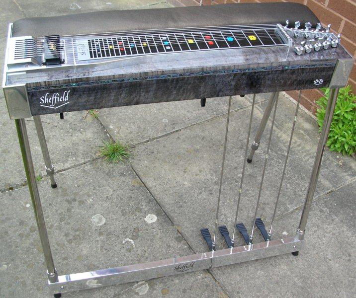

The aluminium neck on the Sheffield is milled from a solid billet and has a serise of pockets milled out along the back, thus making it lighter but keeping the strength and rigidity needed.
Dave. :guitar:
