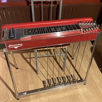

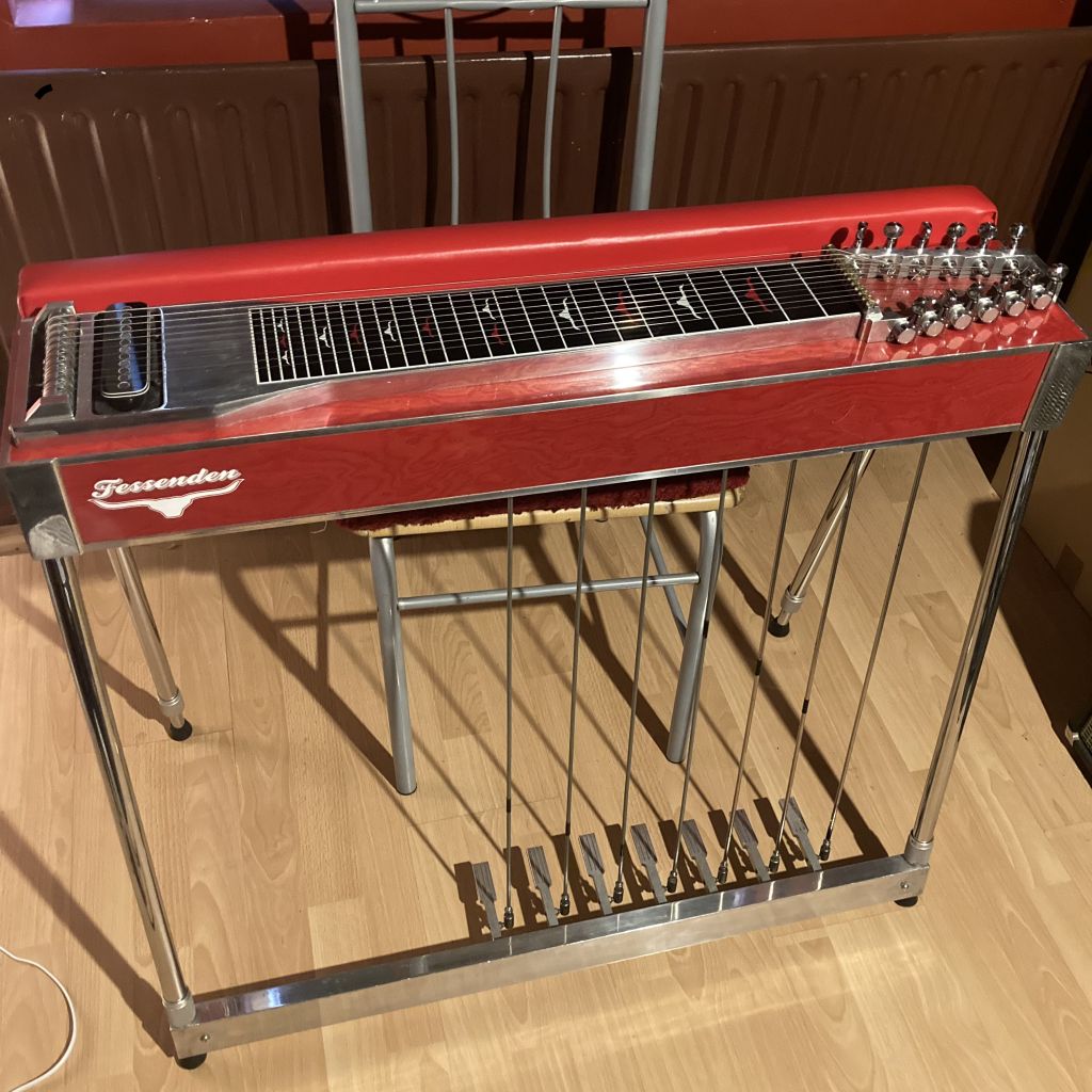

Postby ZakTF » Mon Jun 14, 2021 7:41 pm
Hi,
Today I acquired this Fessenden Universal 12. It seems to be a very nice guitar, and sounds great, but it's set up in "Day" and the levers are also set up the opposite way to what I'm used to.
How easy/difficult is it to change to "Emmons"? The pull rods all just hook into the bell cranks, which I imagine is convenient. And pedals 4-7 can stay as they are for now.
Zak
