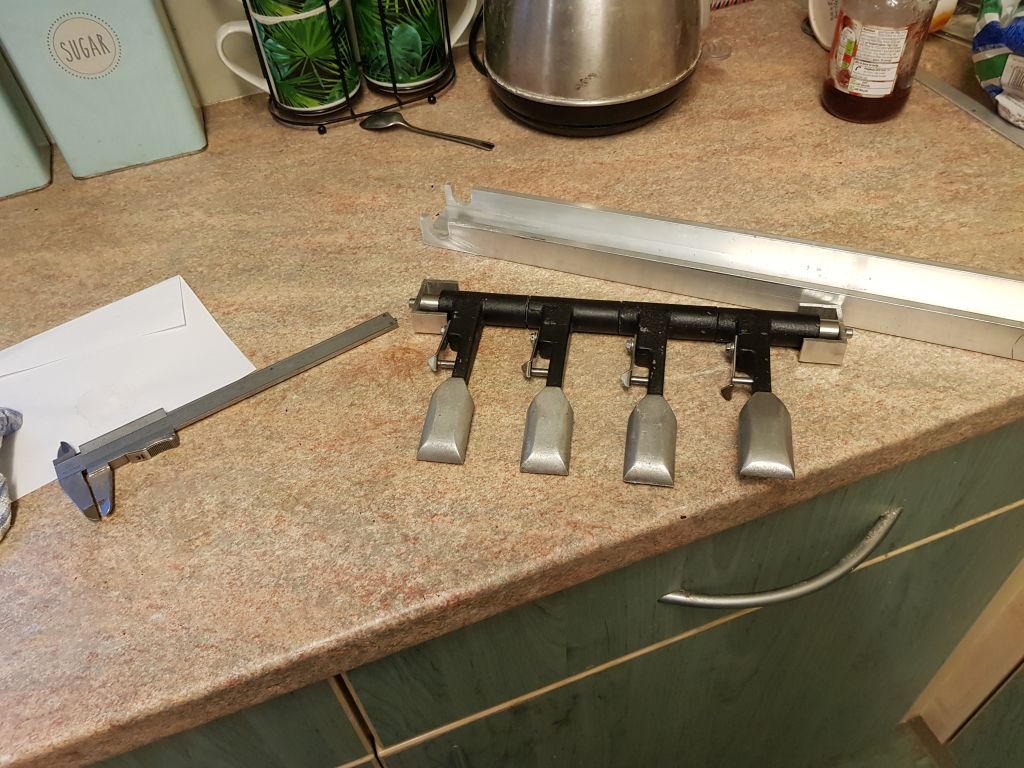

Postby JohnDavisStringsHere » Thu Dec 24, 2020 12:28 pm

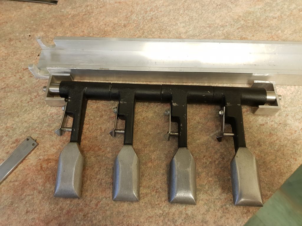

The longest journey starts with the first step so here is a pedalboard in the making.......

Nice to see your keeping busy John, But then you always are. I cant do a lot mate im still suffering with the fractured scaphoid bone, No playing for me for a while :(
That makes my wife very happy :lol:
Merry Christmas to you and your family John.

That looks like a real tidy job, John. All the best with this mammoth project, and I hope you manage to get a nice peacefull Xmas in, and that goes for the rest of you nutjobs on this here forum :guitar:

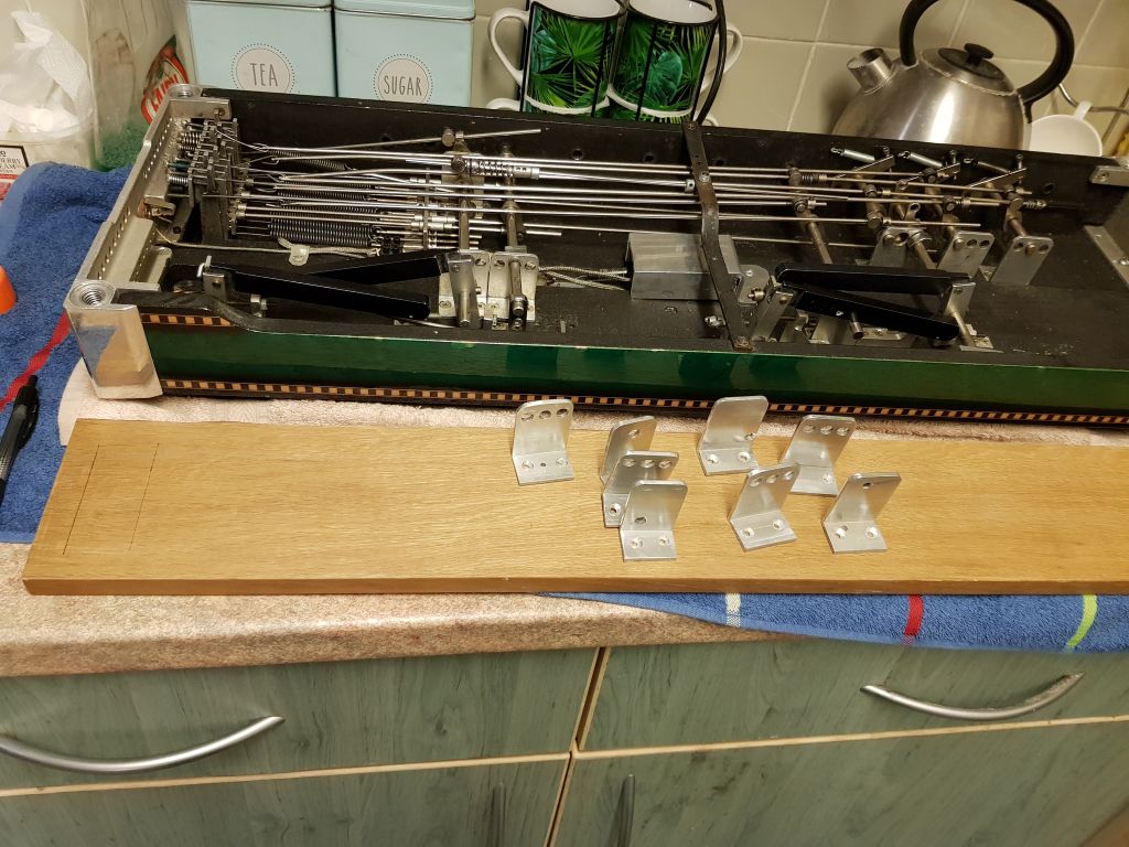

Postby JohnDavisStringsHere » Sun Dec 27, 2020 10:39 am

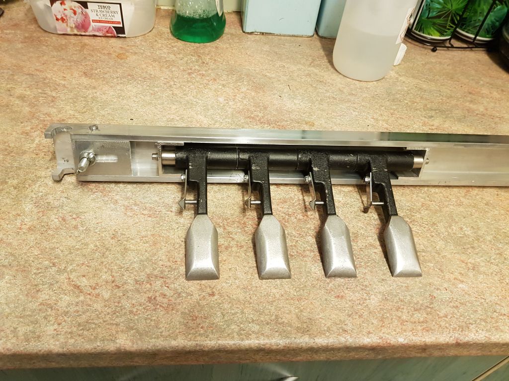

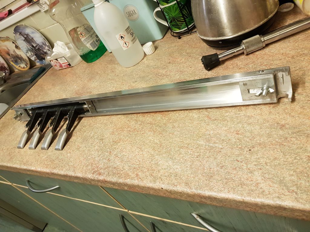

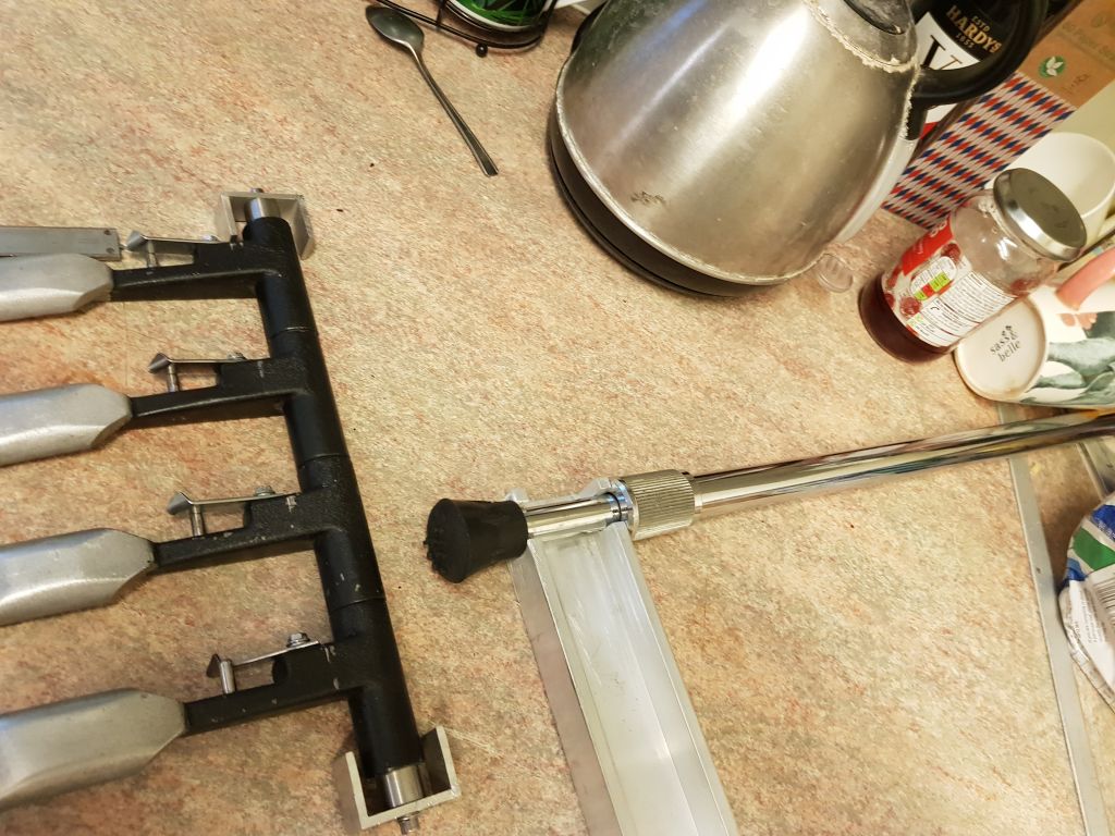

Some small progress,

Postby JohnDavisStringsHere » Thu Dec 31, 2020 8:02 am

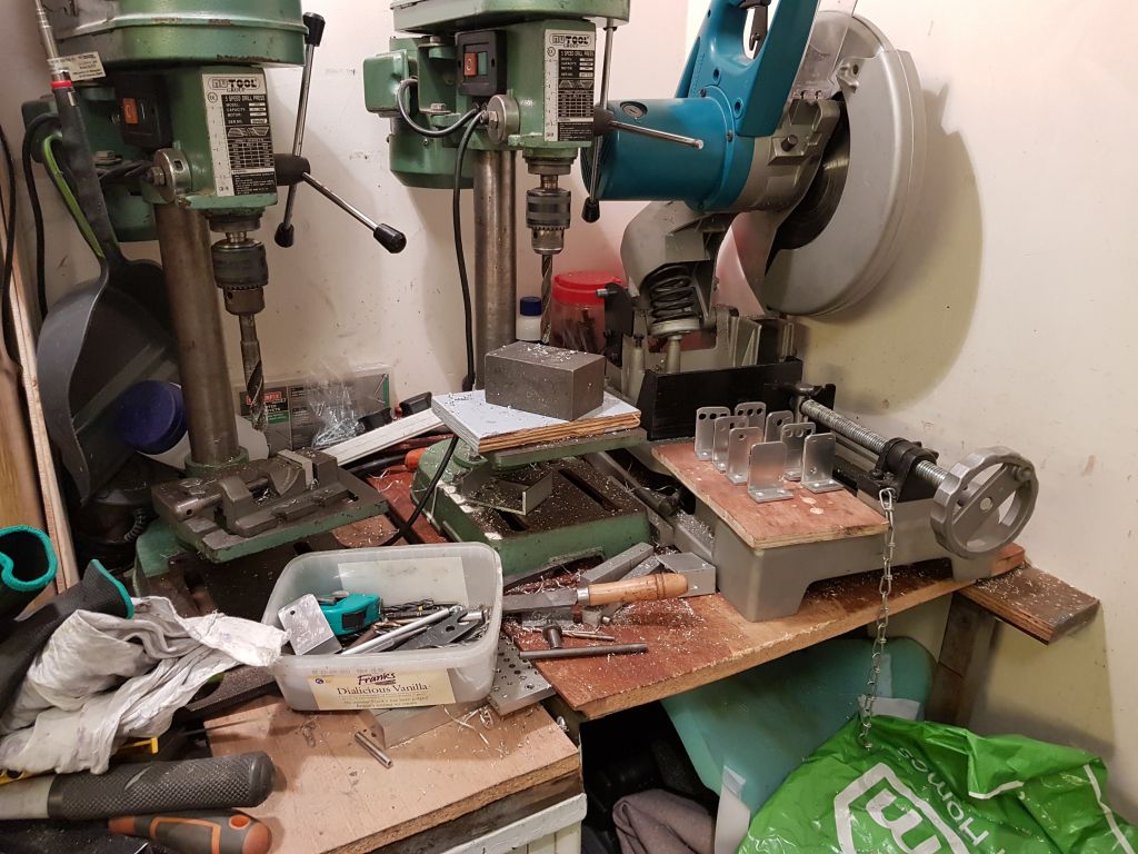

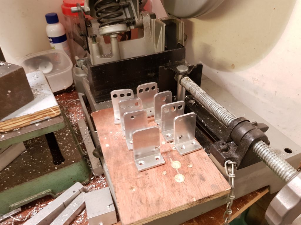

Made a few small axle stands yesterday, not sure if I will use them on my project as they were from old scrap metal i had and have too many holes in them to start with but hey ho I guess they will be lighterto carry. As I don't have the luxury of a smashed up Emmons body from which to take measurements I am making a mock base to start with to be sure I get things right before my timber arrives then all I have to do is transfer the knowledge to the real plank leaving out the mistakes (I hope)

Postby Mcneilwaeasteel » Thu Dec 31, 2020 3:15 pm
John
Your definitely not shy when it comes to engineering projects and I admire your courageous approach to tackling difficult problems! :shock:
A word of warning, don't let health and safety see the picture of that oversized drill bit stuck in a small chuck, it's bad enough if you're just using it for countersinking but if you're drilling holes that size open it up with smaller drill increments at a very Low speed, until your just clearing the final hole, the alternative Gung Ho approach could have everything flying around the room ( including yourself) :o :roll:
Do you have a wood stove handy?
I believe a certain forum member has a supply of firewood to burn that just may have the hole positions your looking for! :guitar: :guitar:
The guitar looks great but did you just buy it to match your kitchen mugs, or have you got them colour coordinated for the steel? :P :lol: Looking forward to seeing and hearing the finished product sometime in the new TEIR or 2021 whatever comes in first! :lol:
All the very best to you and yours
Robert

Postby JohnDavisStringsHere » Thu Dec 31, 2020 3:41 pm
Robert, the color coordinated pedal steel in the pic is my road guitar and needs no attention from me unless we ever get back on the road, then maybe a set of strings
It is a bolt on model and I am using it for measurements for my project that will also be a bolt on mech.
