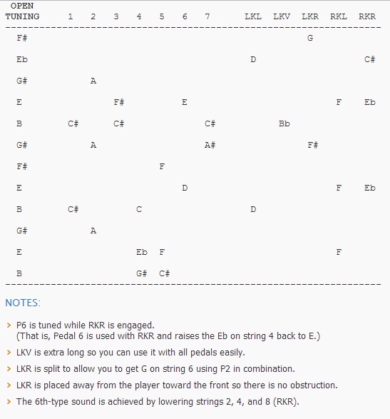

Looking at the co-pedent (below) for the Carter from the Steel Guitar Info site, it seems that LKR is set up to allow a half tone drop to G but in conjunction with pedal 2. Not sure I get this exactly, how I'm reading it is that using LKR and P2 in conjunction lowers a half tone but is this because LKR is lowering string 6 a full tone and P2 is then raising it a half tone, the result being a half tone drop to G? So not sure if this is actually a half stop :?
