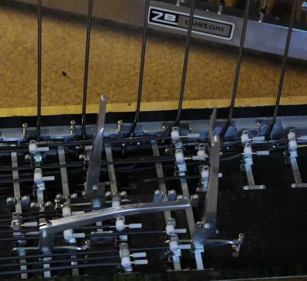

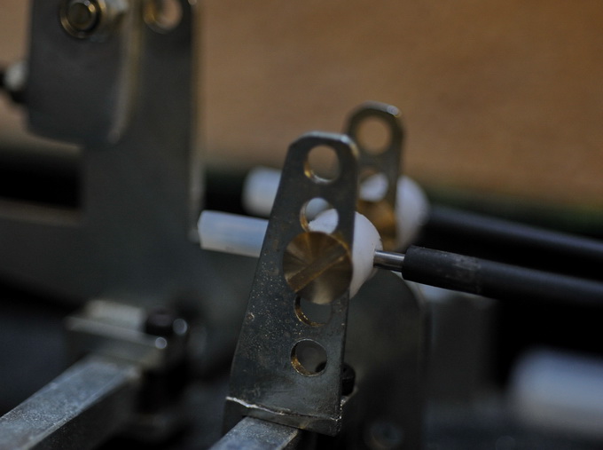

Without meaning to go off topic here, but since we are in ZB mode!and food for future thought!
I got an 11/10 some moths back form Mickey Breach, he had Ronnie Bennett put in a modern undercarriage but he was still finding tuning difficult so I whipped out all the turnbuckles put straight sleeved rods in and bushed them at the bellcrank (as per the pics) giving hex tunability there, so fine tuning could effectively be done between the pedal or lever stop, the end plate and the bellcrank, if that sounds over complicated it’s not you have those options on any all pull. The degree of accurate tuning and stability now is dead on as of course is the tone! It was originally Frank’s guitar and Mickey has it waiting in the wings for his return. So if he doesn’t get his finger out when he comes back and give it some serious playing I’m going to down there and brain him with it! It’s a beaut!

Postby Zebedee » Sun Apr 15, 2012 7:06 am
Assuming that the ZB still has its original changer (with the tuning done at the endplate) I don't see the need for all that extra work, Bob :?
