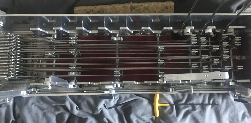

Latest update. Returned from the Far East on Friday to 12 new meter lengths of rod and the correct die for cutting threads. First problem, the die wouldn’t fit my holder without being pushed in which meant it was cutting too deep. I made a rod, slightly wobbly at the thread so resolved to wait for a new die holder. Then the impatient voice in my head took over and, helped by the improvising voice in my head, used a pair of mole grips (the best tool in the world!) to hold the die and successfully made all the rods for phase 1. In case you’ve not seen how Sierra do their rods, the threaded part actually sits at the crank end into a little nylon bush. The other end has a hex brass nut and two nylon spacers and is finished off with another round spacer set across the way. This means the changer finger is pulled by a round surface rather than a random part of a hex tuning nut which seems like a very good idea. I think I might adapt this idea for the MSA, perhaps by putting a drilled bead in between the tuning nut and the finger. Cant do any harm!
Anyway it now looks like this-
And it works too! It was certainly a lot easier than last time I did this and only had to make a few adjustments so far to make it work, usually just swapping round rod positions to get a better pull. The other problem was the vertical lever which was just too low so I thought I might have to make a new one. However a good squeeze in the vice removed the bend and it now sits in the right place at least though I still think I can improve it. A work in progress…

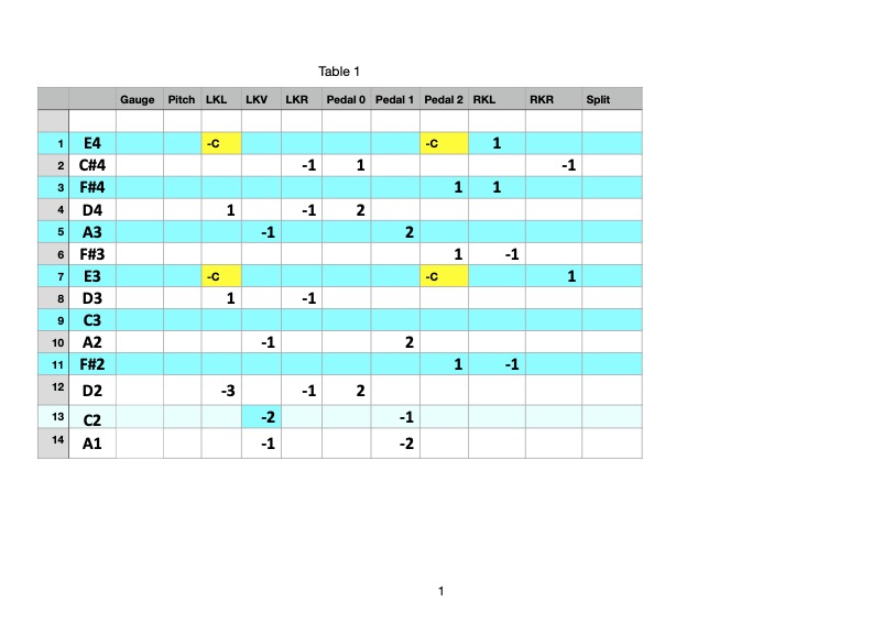

Another good day of progress, unless you count some unnecessary fun with a septic tank! Legs are longer and I now fit comfortably under the thing. Levers are massively improved and now sit in more or less the right place and i have the overlap I need between the E lower and the vertical. The levers on the MSA are works of art and very adjustable. These, less so though there is a very handy 'slide' feature that makes the 'backward' moving knee levers movable. Finished fitting all the rods and everything is working as it should. Added one extra pull on string 13 which is nice for the A pedal minor chord. Put in my compensators too which I had left till the end in case I ran out of rods. its only strings 1 and 7 I compensate these days after much research and experimentation, dropping them a tad when the 9th needs to be a 6th.
Here's what I've done with it, no doubt with mistakes in the chart!

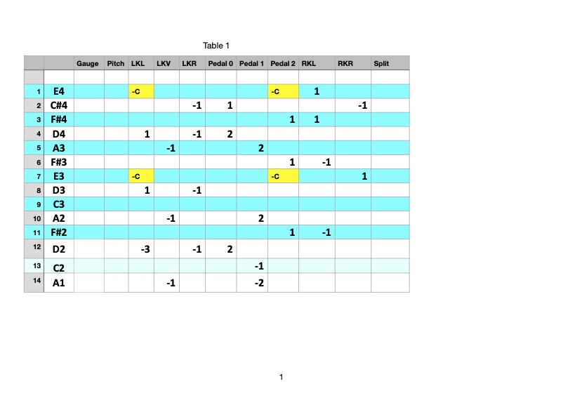

Thanks Bob, you can have first shot when it yarns up at the 'Cosh'! As is normal for me, this iteration lasted less than 24 hours. My music theory isn't too bad but its more of an 'offline resource' and I'm not sharp enough to spot glaring holes until I have a play. String 13 just had to drop a tone on the vertical to make the ABV minor make sense. Now I'll live with it for a while, mainly because I've run out of spacers and hex nuts!
Calum
