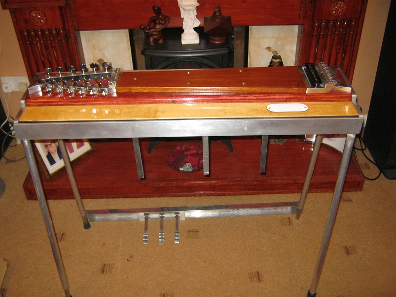

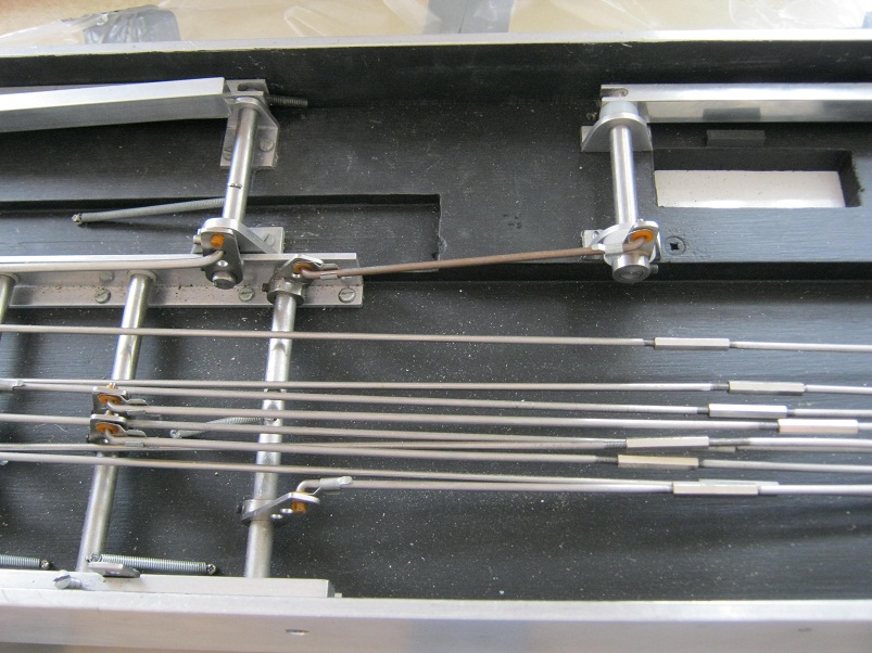

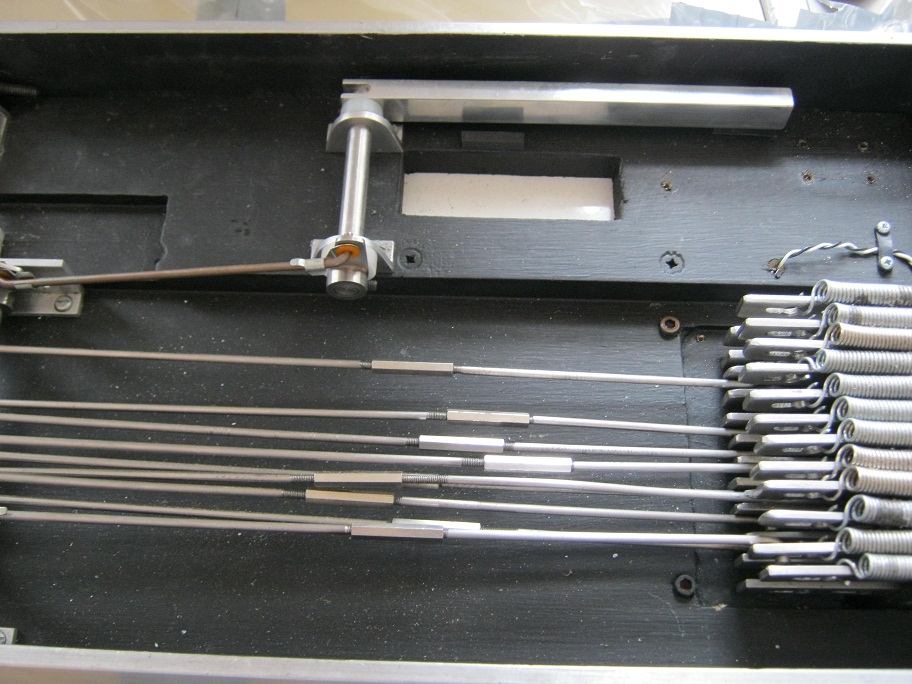

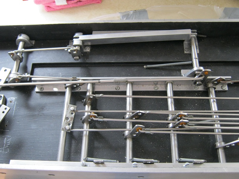

Re: ZB S10 ...3 X 3
Postby bob1 » Wed Jul 18, 2012 9:59 pm

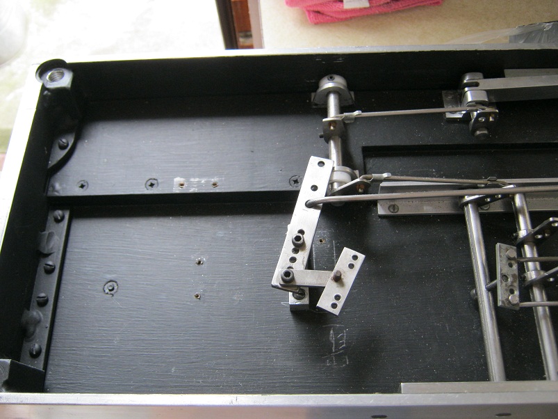

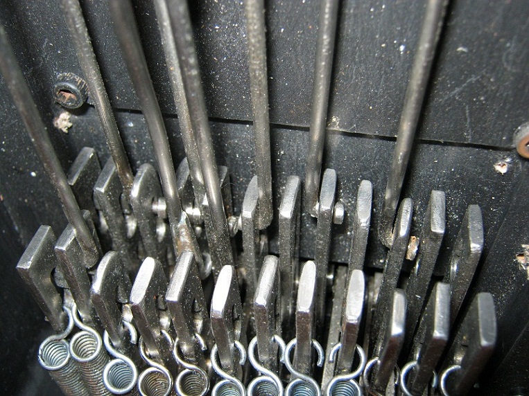

Hi Everyone This is just 4 pictures to let you see what is happening underneath from the changer:
Hope these are ok will let you see what the undercarriage really is.

Re: ZB S10 ...3 X 3

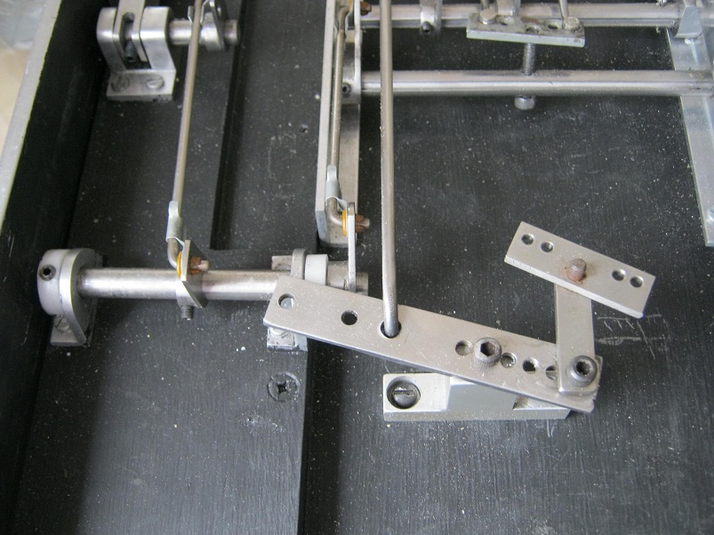

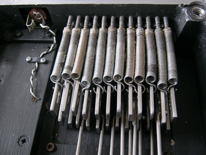

Postby bob1 » Wed Jul 18, 2012 10:57 pm
2 more pictures of undercarriage

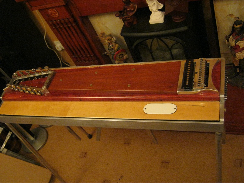

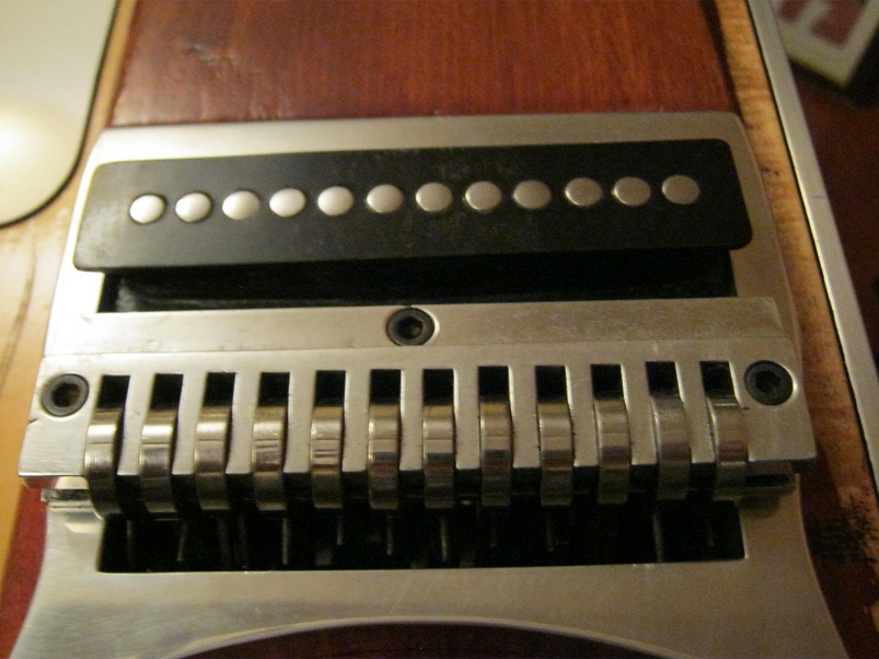

and one of PSG and one of Changer and pickup.
Pickup is supposed to be a Ronnie Bennet pickup.
Now I am wondering where do I go from here ??
regard
Robert (Robin)
As I hope you can see 3rd and 10th strings don't have pins they are different. Maybe this the way they are meant to be. ?
Any idea's of repainting the top maple and mahogany.

Couple more pictures want to see if I can get this Steel kick started to a new beginning :lol:
Thanks Robin
closeup of changer
Any Ideas on staining/painting top
