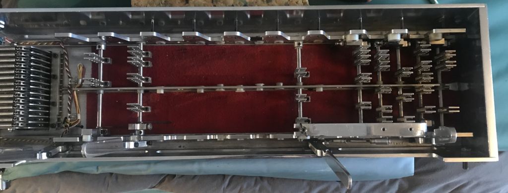

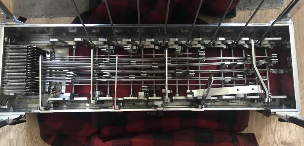

A long weekend due to Covid booster so thought I might make a start on the project to make this machine into something I can play.
THis morning I had this:
Now I have this:
Did a little bit of planning but then just decided that the only way was to go for it. I’ll be changing it many times no doubt! Nearly started a ‘fitting spilt screws’ project but will leave that for another day. I have simplified my copedent even more for this one by removing the C pedal so it will be a 0, AB and 5 lever set up. I could live without that on the MSA as well but I love the big maj7 with the low D and anyway, I cant play them both at once so no harm in a few differences. The Sierra is all about the bass!
Very impressed with the engineering and the cross shafts are superb, much better than the ‘removable’ MSA ones. I mean, how useful is it anyway to be able to spring out a cross shaft? In a complex set up, so many rods have to come off anyway to get to the cross shaft so not really much more hassle. The Sierra lets you pull the shaft through the slots in the apron and it just feels fabulous. Pretty much zero play but still super free so a much stronger solution than the sprung ones which do tend to wobble about a bit.
I got as far as putting on most of the raise rods but then I ran out of long ones. As the guitar had been uni, there are loads of the middle sizes ones that I wont need. And that will do for today…..
Calum
