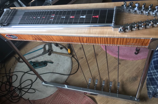

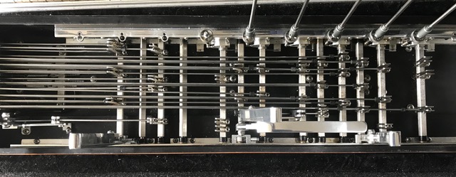

Some pics of my new pride and joy which arrived yesterday. Only problem was it was a uni set up and that's not for me. So a deep breath, chant the mantra 'how hard can it be' and pick up the tools. I naively assumed I could do it a bit at a time - swop the E's to the left knees first for instance. No chance! Pretty much had to take all the rods off apart from a few to keep things in line and then rebuild from scratch. Very successful and its all playing in tune, splits and all. Left one pedal for 'future development.
Now just need to learn to play it......

A bit too soon to fling it in the sea yet Robert! The hammer nicely forms the slight round in the end of a rod. I had it down to only the four pedals for about an hour but couldn’t help myself.

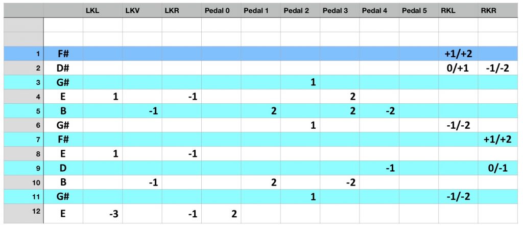

Not so much a boffin, just a guy wanting to play a few wee tunes! Trickiest part was getting my string 5 sorted out. I use pedal 4 to do the Franklin style lower of a tone which I can also use to cancel out the raise on pedal 3 and get 4 raising a tone on its own. So this required a tunable split but so does the vertical lever drop of a semi tone. The answer was to fit an extra rod for one of the splits and use the built in one for the other. Worked out well!
Also if it helps anyone else, I found that the raise helper spring setting is quite critical for certain string lowers. Too much tension and the string just wont go far enough.
