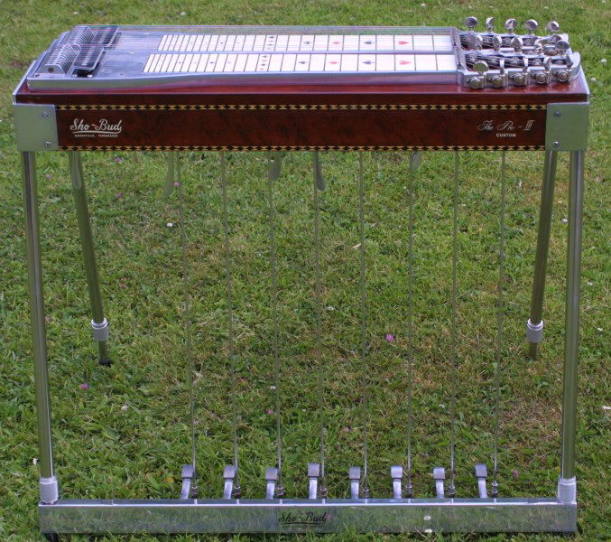

I know that is a contradiction in terms. I got my guitar (Pro 111 Custom) back from Bob Adams yesterday. I will be posting some before and after shots later, but I can say at this stage that the end product is nothing short of astonishing.
There will be no Bud in the world that looks quite as pretty as this one. :lol:

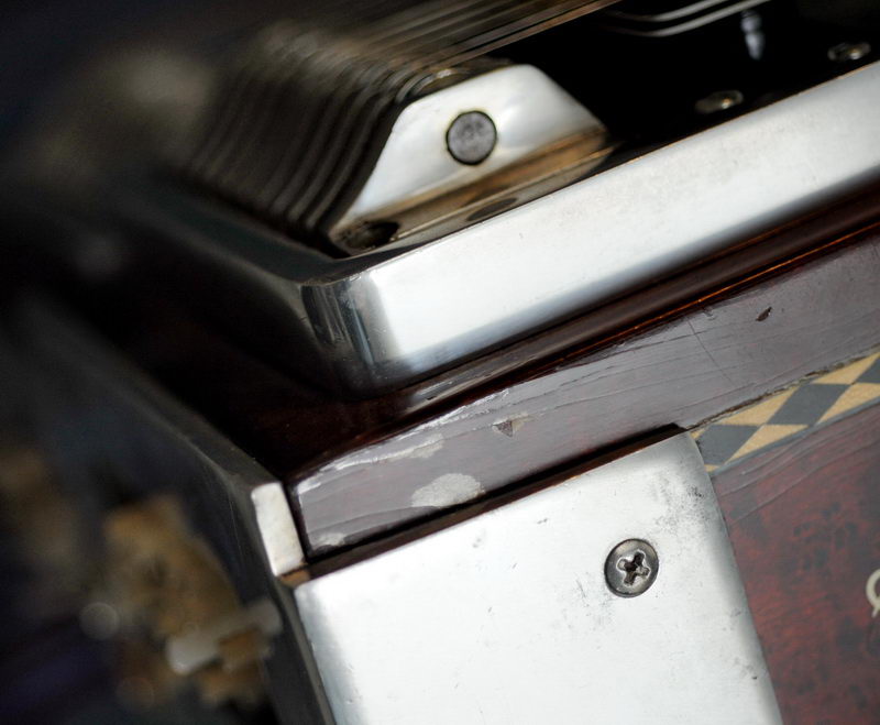

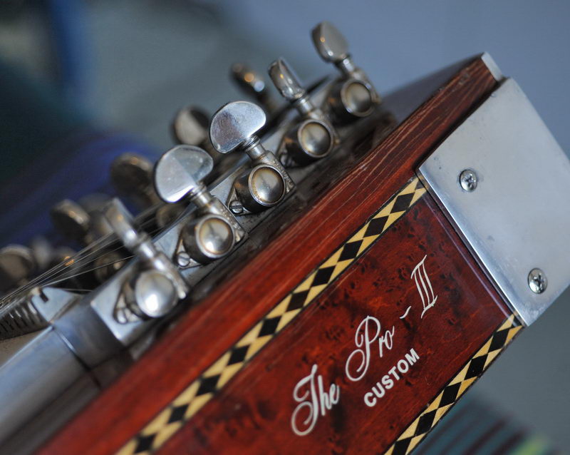

Some BEFORE shots. You will see in the close ups how the lacquer is badly checked, and the inlay appears to be coming away. This guitar is circa 1976, and has had a hard life doing thousands of gigs and a hundred and thirty five albums. One thing that hurts lacquer finish guitars is taking them from freezing conditions into a warm or hot room and visa versa. There are also a number of bar dings that are not visible.

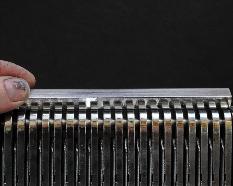

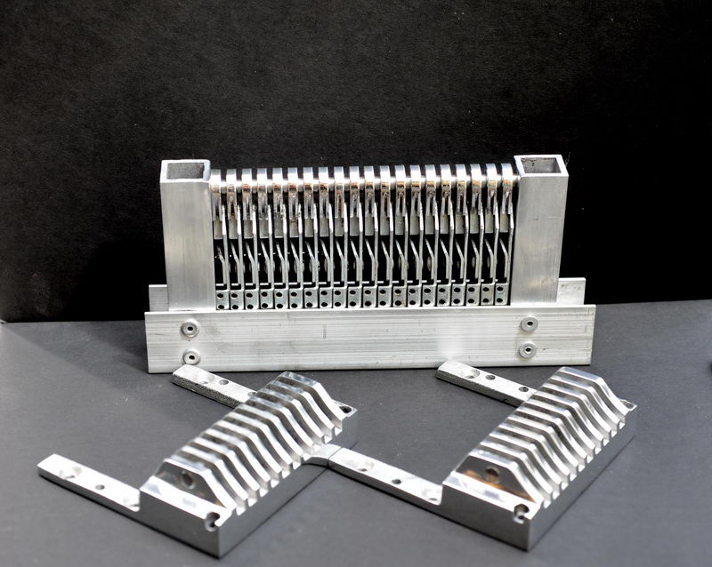

Bob removed the changer fingers which had significant grooves in some of the E9 changer rollers. They were polished and lined up on Bob's special jig and then checked with a straight edge. You will see a mark on Bob's thumb where he had been using a lump hammer to get the fingers to line up. :lol: (Just kidding - it was a sledge hammer).

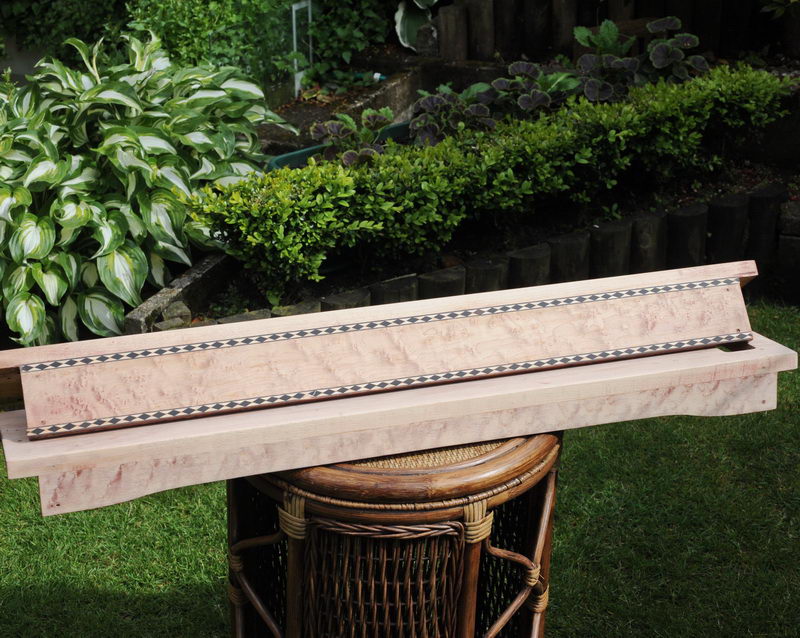

Here she is shorn of stain and lacquer. The birdseye grain underneath is not too bad. There are no bad surprises under the stain as there are on some 'Buds.
