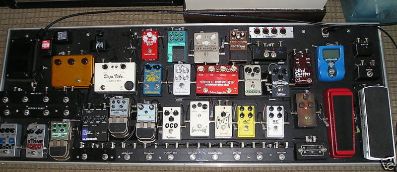

I use quite a few pedals simultaneously, so if I add a compressor to my current rig, will it make me sound like Buddy ?

Nice pedal board Zeb, though not entirely sure how you work it all with your feet on the ABC pedals.
