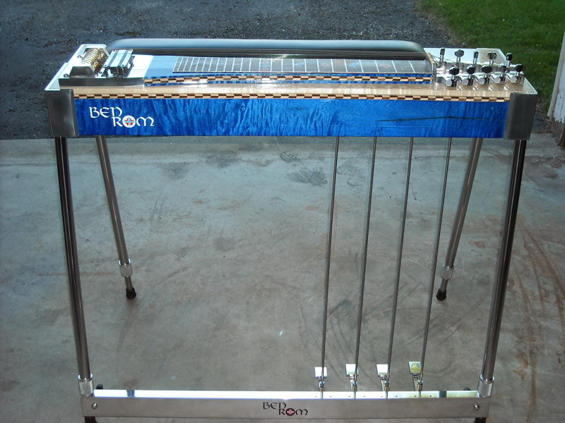

Here we have my newly completed steel number 4.
This BenRom has 4 pedals and 5 knees.Make sure you check out the detailed pics here as well:

One or two questions - the roller nut would appear to be set higher than would normally be seen on a pedal steel. Was this to accomodate the Alumitone pick-up, or to decrease the amount of hysterisis at the machine head assembly?
Also, does the extra height of the strings above the fretboard cause additional parallax issues?

Ken, The height of the strings above the neck is 3/4"... a very standard measurement. Several commercial steels use this.

Is it #1? where the eye of the player gets thrown off re fretboard/bar placement. In that case I have not experienced a problem, since I have the same distance on Red and are used to it. The buyer has a well known brand now and it is the same distance on it.
The Alumitone slid in there easily, under the strings, minus the mounting plate. I didn't need it because I have my own plate in the cavity.

Bent - it might just be an optical illusion on the picture. Yes - parallax affects the angle of the eye / bar in relation to the fret positions on the neck, and can be affected by seat and body positioning in addition to string height.

Ken, yes, I had a guy here comment on the string height as well, and we came to the conclusion that it could be an optical illusion caused by the camera angle.

As for the Alumitone...I believe it to be brighter and clearer than a humbucker. In some instances it reminds me of a single coil. It has LOTS of volume.
I will be trying the Tonealigner as well before I deliver this guitar, so we'll see.
If it hadn't been for the hum, I would have put one of my homemade single coils on it. I like the tone in those the best. But I believe the hum is not as bad in England and Norway as it is here, with the 220V/50HZ electric supply. So maybe I'll give him one of mine just to try out.
