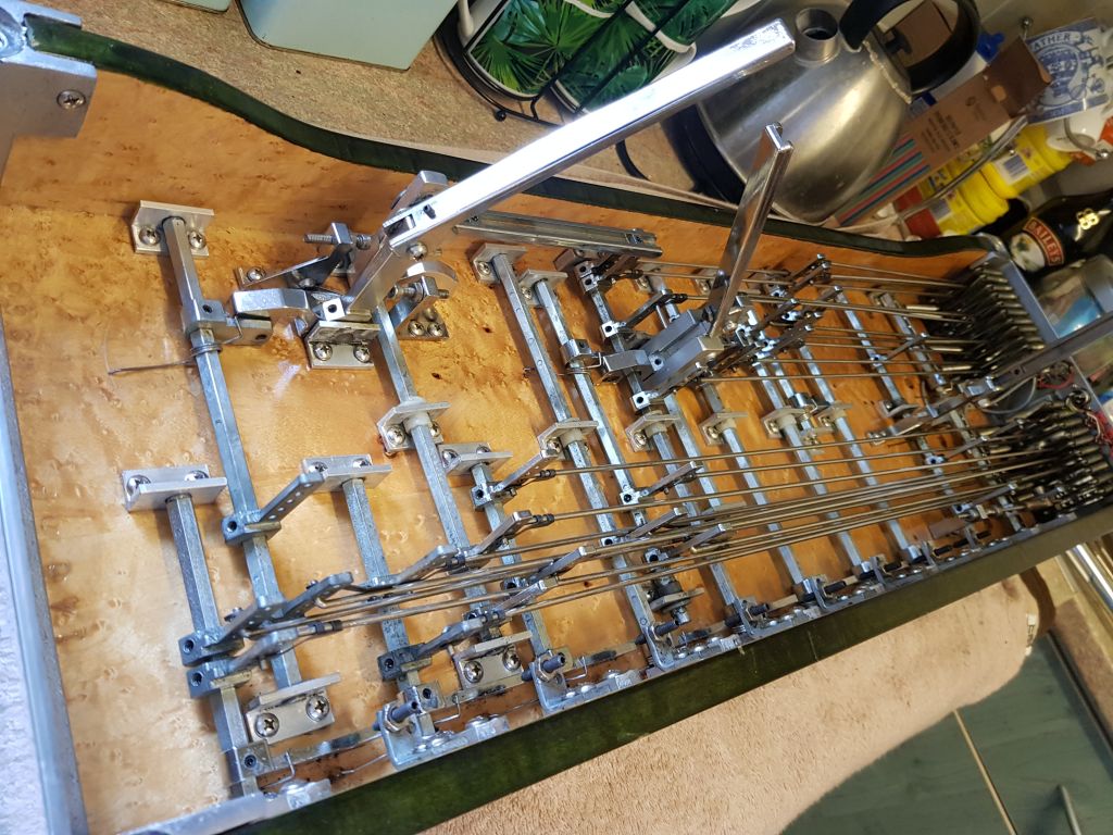

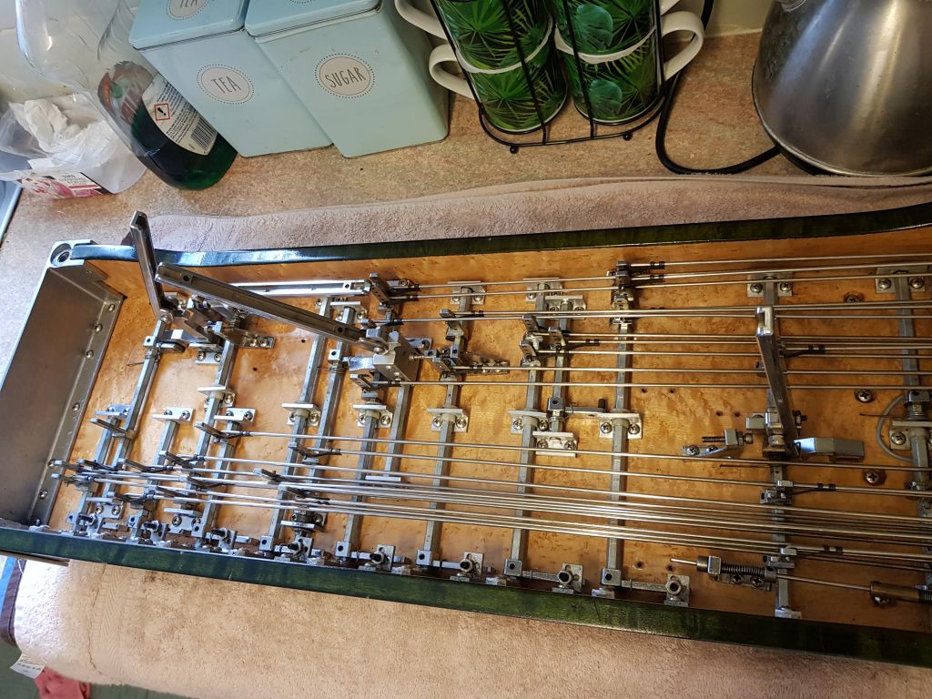

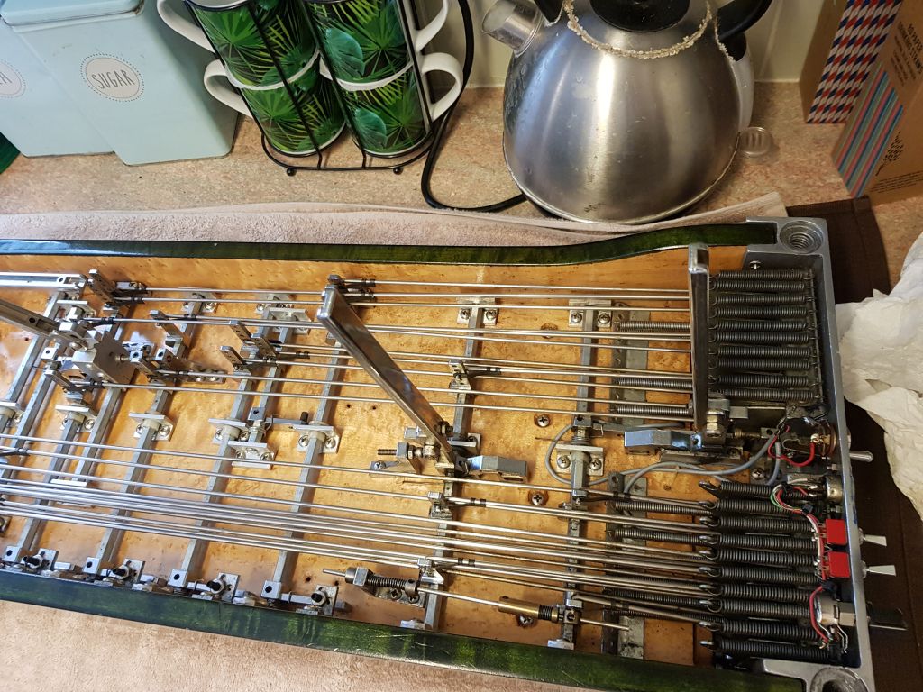

Well this lovely old guitar came to me with her knickers around her ankles,unloved and un-cared for...not worthy of the name "Super Pro" But after a bucket full of TLC I can show pics of her underskirt could not post the B4 pics too painful :oops: but here is the here and now pics.

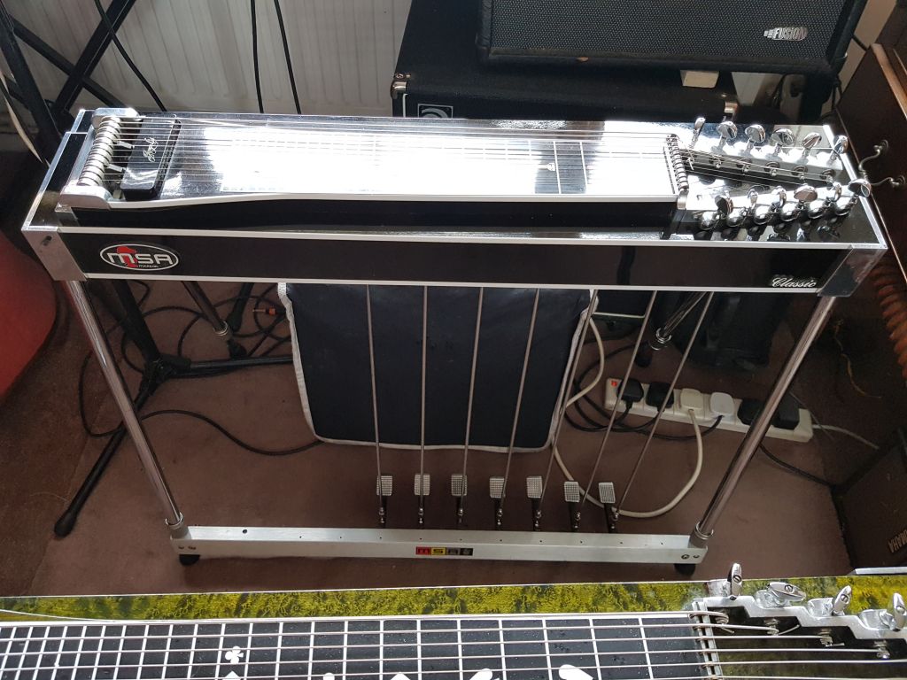

The MSA Uni 12 limped in with an imaginary string roller nut problem, I am not sure if MSA grade their nut rollers or not, I did swap them around as one appeared to have a slightly deeper grove but IMHO I believe the main problem was the position of the string as it leaves the tuning peg. With a 12 string you have less leeway where you let the string leave the peg as everything is crammed into a slightly smaller space, any how prob fixed = no prob.
