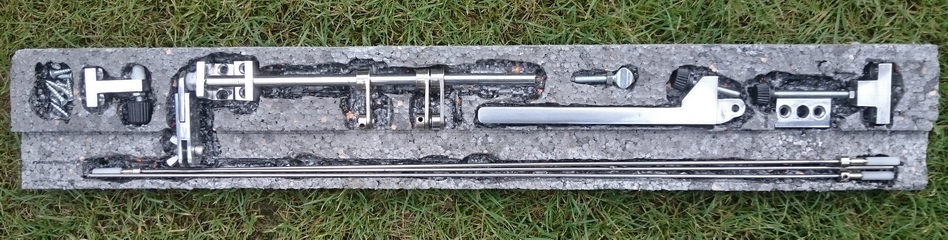

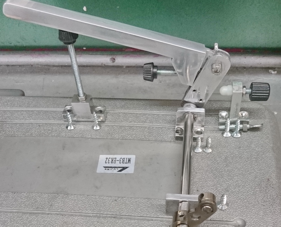

Vertical Lever assembly on it's way to Mr Park for Franklin Change on the LDG . with you tomorrow Matt! Enjoy!
Stop screw to be cut to required height!

Postby JohnDavisStringsHere » Tue Sep 27, 2016 6:12 pm
Nice work Bob he will be well pleased :)

Postby Ken Byng » Wed Sep 28, 2016 10:51 am
Bob - that long stop bolt that you have in place (pre-cutting) is the same length as the pedal stops on the Bentley guitar that Davy Adams bought. Every time that a pedal was pushed, the bolt would flex and the whole thing would be out of tune. :o

Postby bob adams » Wed Sep 28, 2016 11:26 am
Good grief Ken! You are joking!
That stop and the crossbar were over size so that Matt could cut to suit!..... It is fun trying to do this remotely and make sure every thing fits where it should but I've just spoken to Matt and he is right on track with it all!
(Donny.. Never thought! just wanted it all sorted for you before the meeting... it sounded great!)
