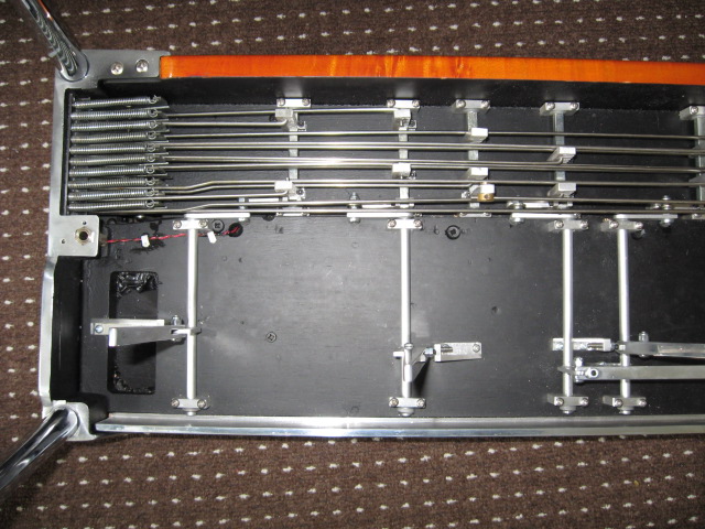

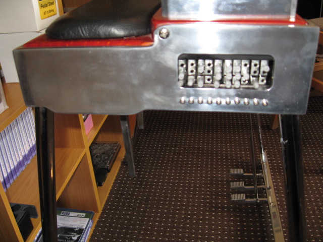

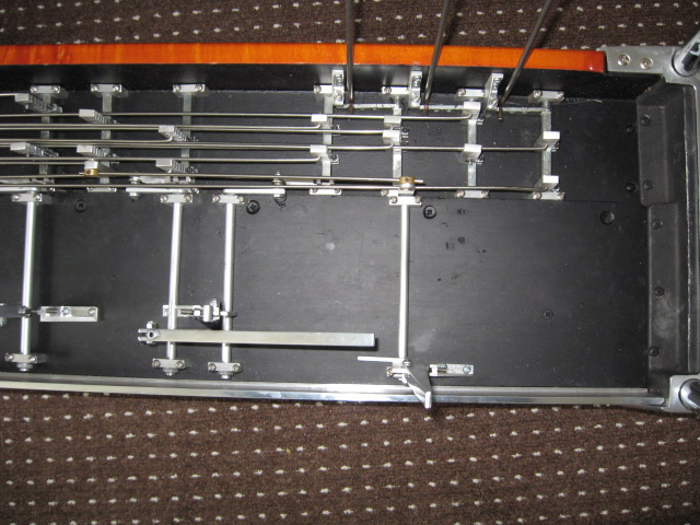

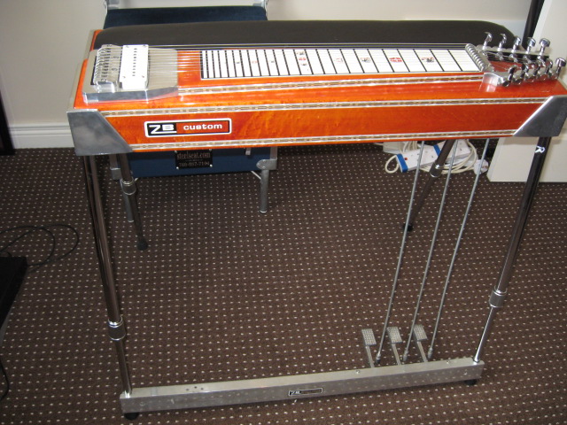

I recently had a beautifull ZB SD10 reworked by Ron Bennett. Before I sent the guitar to Ron, it was a nightmare to play.
The pedal and k/lever action on the guitar was really bad, due to the poor design of the "up-dated undercarriage"
The last batch of ZB Guitars were built by a gentleman called Basil Smith from Fort Wayne Indiana. Basil was tragically killed in a car accident a short time after he bought the company from the Bromley family.
Ron Bennett removed the changer and all the undercarriage, and started from scratch. He fitted a new changer and a complete modern undercarriage with 5 slot bell-cranks and the result is a superb playing steel guitar with great pedal action,wonderfull feel to the k/levers (short travel and positive stops) and retaining the class looks of the original cabinet.
If you are a ZB fan, and are thinking of upgrading your guitar, look no further than Bennett Steel Guitars. He does a great job at a very reasonable price. Thanks again Mr.Bennett
