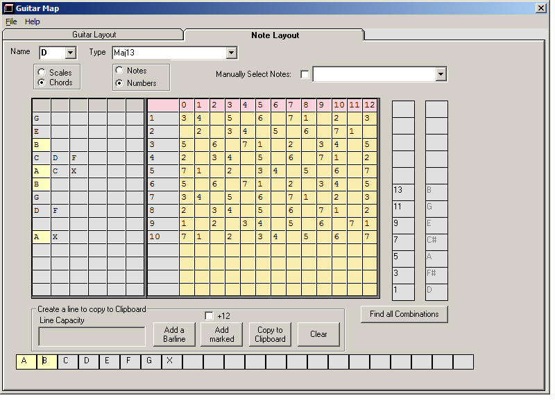

Postby henry » Fri Jan 24, 2014 8:58 pm
you put your tuning into the app (it's got a fairly standard E9 by default)
then you can tell it to show you where all the notes in a chord are
it's a bit like the spreadsheet that Joe Wright uses
in this example I've set it to show DMaj13 notes. I've set it to have pedals A and B down.
If you look at the open position, fret 0, it is telling me that there is:
root note on string 9
2 on string 8
3 on string 7
5 on string 6
7 on string 5
etc, so notes 1,3,5,7,9. not bad but no 13th
(it shows 9 as 2, 11 as 4, 13 as 6 etc)
but then if you look at fret 9 you've got
13th on 9
7th on 8
3rd on 6
7th on 4
3 on 3
so no root but 3, 7, 13. pretty useful inversion
and you could get a higher 13th on the 2nd string if you lowered it a semitone.
I would never have found that chord!
the E9 one I use for maj13 is in the root position, getting the maj7 on 2nd string and the 13th on 5 and 10 with the A pedal down..
searching for Dmaj13 with A and B pedals down.

Postby Nick Bidmade » Sat Jan 25, 2014 9:25 pm
Ouch! Looks very complicated... but also far more sophisticated than my system of pecking around the fretboard, checking notes one at a time via the tuner. Slow, but usually works, although I did have to send out an SOS for an 11th chord when I couldn't find a workable solution!
Does this system also cover U12? It seems to me that the additional strings, pedals and levers on U12 gives you far more variables and combinations than E9 and this software could be really helpful.

Postby henry » Mon Jan 27, 2014 12:47 am
i think you can add and modify the copedents.. It's got a E9 and C6 built in
