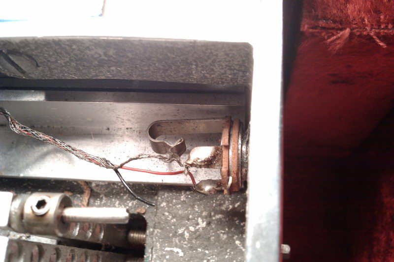

I went to one of John's lessons a couple of months ago and he said (very politely!) he reckoned my guitar sounded a bit thin. I saw another post about someone who'd sorted the sound of their guitar out by fixing a loose earth wire from the pickup.
My guitar's got a black wire that is unattached, so I thought soldering it on somewhere would fix my tone trouble.
The question is where? To the chassis? or somewhere on the jack?
Any help much appreciated.

cheers James. I'm a bit confused cos the pickup seems to have three wires.
It's nothing fancy as far as I know, single coil and no coil taps I think.
There's a coax with shield and centre, then also this black wire?
I will try contacting it as you suggest to see what sounds good.

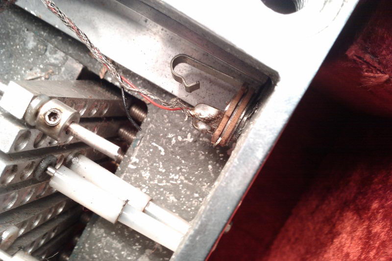

Postby henry » Wed Feb 02, 2011 7:28 pm
I let this slip, but talking to Richard at John's meeting made me think more about it.
As you can see, there is a black a red and a shielded cable. Red connected to one shielded to the other and the black one is loose.
Richard was saying that two cables and the shielded cable might mean it's a coil tap?
If so do I connect both to where the red cable is?
But, it looks like it's come loose from the bit the shielded cable is connected to?
Another thing that confuses me is that the jack has three connectors. Doesn't that mean its a stereo jack? :?
any help much appreciated.
Henry

Postby James Crowbear » Thu Feb 03, 2011 7:56 am
yup ! looks like a stereo jack all right
which means 2 hot & 1 ground
James Crowbear
Re: loose pickup cable
Postby Jim Pritchard » Thu Feb 03, 2011 2:31 pm

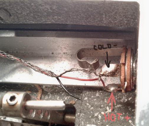

Just had a look at your photos with broken wire. This is a standard mono 1/4" chassis jack socket. The Red wire looks like it is correct (hot or+), the Black should be soldered to the other pin (cold or-). The braid may also be connected to the cold as this would stop any humming/microphonics etc. I'll try and add a modified photo for you, hope this helps. Jimbo.

Postby bob adams » Thu Feb 03, 2011 3:21 pm
Jimbo! Wins the Coconut! The colours can be confusing Henry, most of the newer psgs are black and white but there are various (red +two browns .. White + two blacks etc. but Jim’s info on yours is correct. We done that man! ;)
