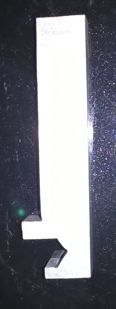

There should be no problem adding a third pull to your RKL. I had it on my Mullen D-10 and have four pulls on a couple of levers on my Sierra and Fender/Bud. Also it's very easy to work on Mullens, and it's especially easy to add a pull to an existing cross rod. The Mullen bell cranks slot on from the side of the rod and hold fast with a grub screw that bears onto the 60degree side of the hex rod through that little ledge on the left in the picture. Then it's just a matter of threading a pull rod and bending the rt.angle hook at the crank end. I managed to fine-drill the rods to take the tiny split-pin that Mullens use, but you can secure it in several home made ways.
When I sold my Mullen the buyer wanted the RKR/RKL swapped over and it took well under 15minutes to do it.
Here's one I made earlier, but didn't (need to) finish. So you can see how easy it is to hacksaw and file to shape? Or get one made by somebody like Bob Adams if you're not familiar with metalworking (particularly tapping threads - a wonderfully satisfying task :D :roll: )

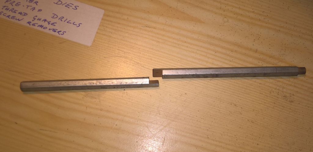

The additional C-C# pull requires only one crank and a pull rod. If you want extra separate pulls you will need to go down the route of adding cross rods, levers, bell cranks and pull rods, which is a major undertaking - but quite possible as you can get split cross rods that feed in under the gubbins without taking the guitar to bits :lol: (A split cross rod has a scarf joint in the middle that secures with a set screw).
