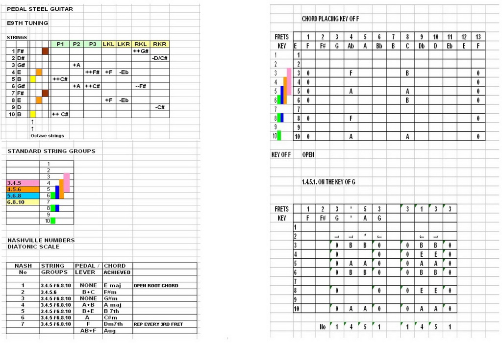

I put this together about seven or eight years ago to assist new players, I seem to recall there was one minor mistake on it but I can't remember where, I'm sure some of you will have great fun trying to find it!!! :lol:
This puts some of what the guys are saying here into visuals.
