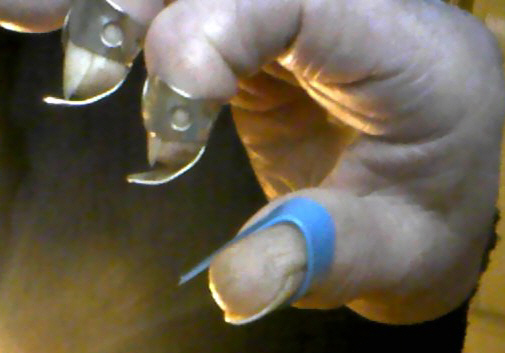

Postby Tony Russell Davis » Fri Mar 20, 2020 12:01 pm
Fingerpicks produce the best "angle of attack" on the strings. Finger nails are in the wrong place for steel guitar as your hand and wrist are bent differently to standard guitar.
I've said this so many times before but don't tire of the advice - Keep trying and (as already said) it gets easier with practice 'til you don't notice.
Shape them to your own comfort, mine curve round so the tip is just in front of my nail, and my finger goes into a slight funnel shape of the "ring" that nips gently into the skin to stop them dropping off (even with the obvious arthritis-y joints!)

Postby icu81b4 » Fri Mar 20, 2020 1:50 pm
Thanks for the tips (no pun intended) and I appreciate the close up photo too. I'm not sure what gauge my picks are as they came with my PSG (Kyser USA) and I can't see any numbers on them. But whilst we're on the subject, when I play guitar I use a thumb and 3 fingers for pickin' but I notice that all the PSG player only use thumb and two fingers, I guess that's all you need for a chord, but it surprised me a little.
